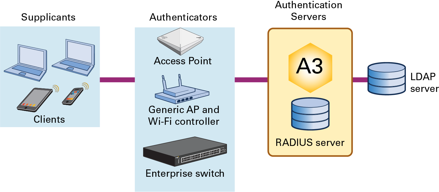

RBAC (Role-based Access Control) authenticates users and their devices with information provided by device-resident supplicant software. This information is matched against internal databases such as AD. 802.1X protocols define the way in which the components talk to each other. A variety of encryption techniques are used to ensure the security of 802.1X protocol messages, including the EAP (Extensible Access Protocol). EAP variants are covered inExtended Authentication Protocol (EAP) and X.509 Certificates. EAP requires X.509 digital certificates, which are covered in PKI Providers.
The figure below illustrates the components involved in RBAC.
Role-based access control
Supplicants
Supplicants are client devices that seek access to the network. They run device-resident supplicant software that supplies credential information to the authentication server.
Some common credentials include:
One or more credentials can be required by the authenticator. Supplicants can be integrated with the client OS, or supplied by third parties. Installing and configuring supplicants can be a time-consuming and complex task. You can automate this and other configuration tasks using automation and MDM (mobile device managers), which are described in Provisioners.
Authenticator
An authenticator is a device that blocks or allows traffic to pass through its ports. Many types of devices can serve as authenticators:
Authentication Servers
Depending on the type of authentication you use, a number of servers can be involved. At a minimum they include:

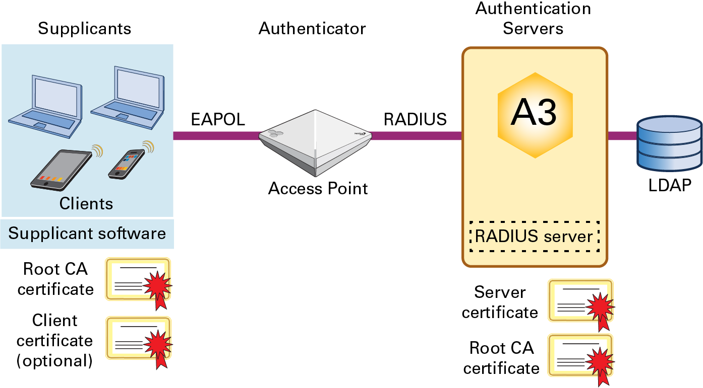

EAP is an authentication framework that facilitates secure communications between clients and authentication servers. The figure below is a simplified network diagram featuring Extreme Networks components.
EAP x.509 Certificates
An AP serves as the Authenticator. Messages from clients to the AP are sent using the EAPoL (EAP over LAN) protocol. They are then encapsulated in RADIUS messages and sent to A3.
Most EAP methods use X.509 digital certificates to ensure identity and to set up encryption. Three possible certificates are required:
X.509 certificates are generated and maintained as part of a Public Key Infrastructure (PKI), which is covered in PKI Providers.
