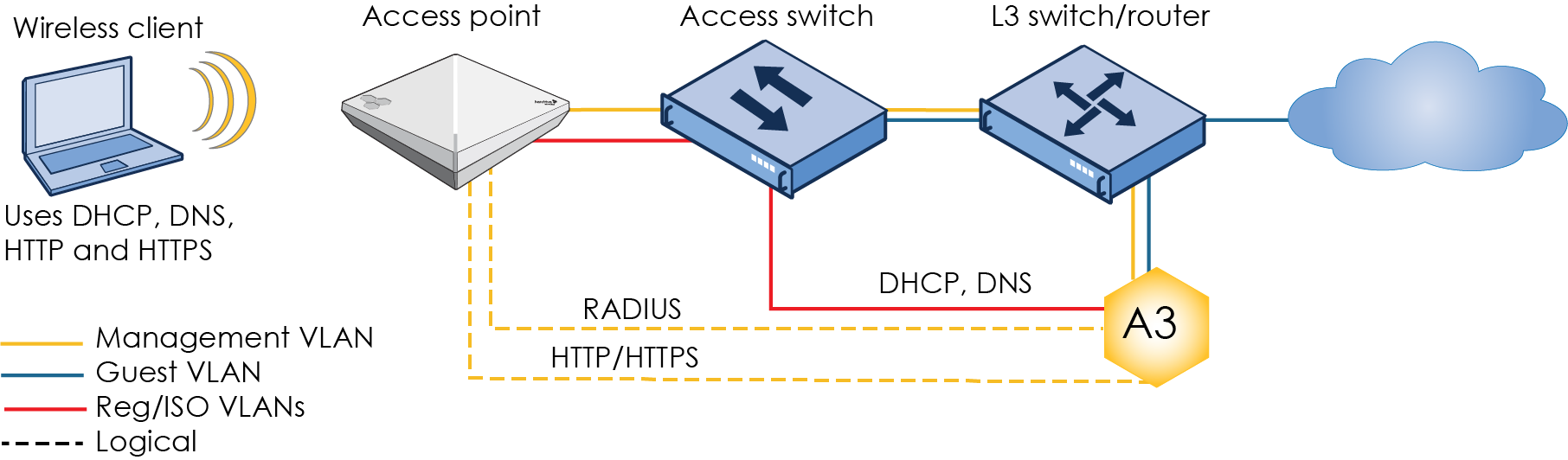

This deployment mode allows for complete, fine-grained network control and scales better than inline deployment mode. To ensure correct IP and VLAN assignments, A3 must receive all client DHCP and DNS requests sent from networking devices. In Layer 2 deployments, this is accomplished by connecting the A3 server to the access point via a switch. A3 receives DHCP requests and responds with an IP address on the local registration or isolation network. A3 also responds with its own IP address as the DNS server and the default gateway.
This deployment mode is shown in the figure below. An Extreme Networks AP is used in this figure, but an access switch or other intelligent network device can be used.
This deployment model can be used with VLAN, Web Auth, and RADIUS enforcement as described in Enforcement Modes.
A3 Deployment with Reg VLAN
