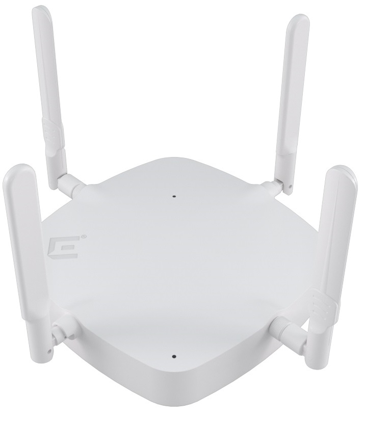

The AP3000X Access point
The AP3000X access point with the Extreme logo on the left side of the device
