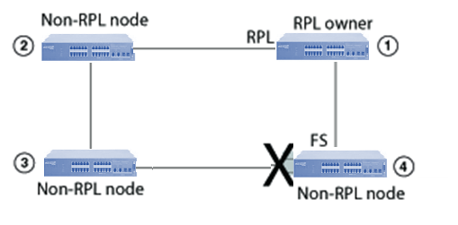

The following figure shows a port failure on ERN 4.
The following table shows the sequential order of events triggered as a result of an operator-initiated forced switch command entered from ERN 4.
