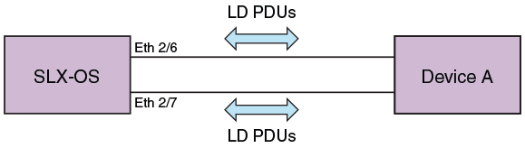

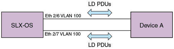

In what is referred to as strict mode, LD is configured on an interface. If the LD PDU is sent on an interface and received on the same interface, that port is shut down by LD. Strict mode overcomes specific hardware issues that cause packets to be echoed back to the input port. The following figure illustrates strict mode.
Strict mode

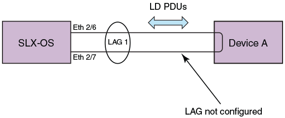

If the user provides a VLAN, then the PDUs are tagged accordingly. Otherwise PDUs are sent untagged. With a LAG, PDUs are sent out on the port-channel interface. If Device A has a loop (for example, a LAG is not configured), then the PDU is flooded back to SLX-OS, which detects the loop. In case of a loop, the port-channel interface is shut down. The following figure illustrates LD on a LAG.
LD on a LAG

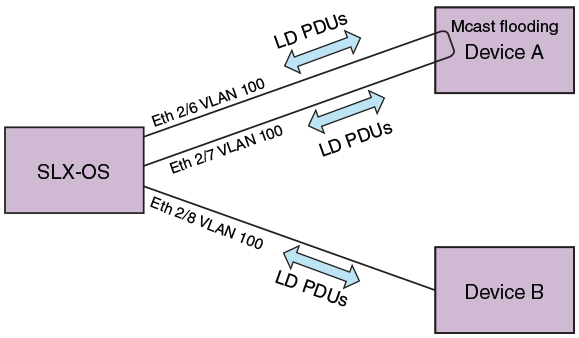

In what is referred to as loose mode, LD is configured on a VLAN. If a VLAN in the device receives an LD PDU that originated from the same device on that VLAN, this is considered to be a loop and the receiving port is shut down. In loose mode, LD works at the VLAN level and takes action at the logical interface (LIF) level. The following figure illustrates loose mode, with LD on a VLAN.
Loose mode: LD on a VLAN
SLX-OS generates the LD PDUs on the VLAN. if Device A has a loop, PDUs are flooded back to SLX-OS, which detects the loop. SLX-OS then shuts down the receiving LIF of the port on the VLAN.
LD supports 256 instances of loose mode, which means that it can be enabled on 256 VLANs.

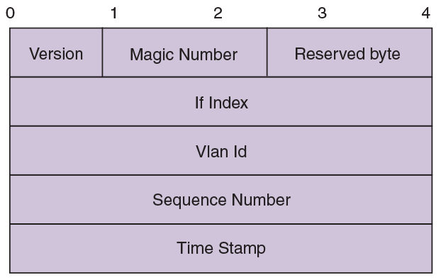

The following figure illustrates the format of the LD PDU in bytes.
LD PDU format in bytes
Parameter Definition
Version LD protocol version (1 by default)
Magic Number 0x13EF; used to differentiate between LD multicast PDUs and other multicast PDUs
Reserved byte For future use
If Index Index of the source port; populated only in strict mode
Vlan Id VLAN ID
Sequence Number Reserved for future enhancements
Time Stamp Reserved for future enhancements

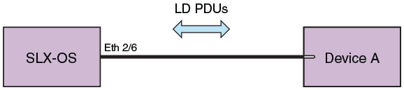

In strict mode, the parameters in this section are configurable at the interface level, and the configuration is specific to an interface. The following figure illustrates strict mode configuration.
Strict mode configuration
