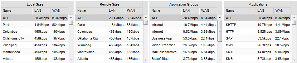

Moreover, the Application
Flows frame has four filters: Local Sites, Remote Sites, Application Groups and Applications with,
for each of them, their name, LAN throughput and WAN throughput:

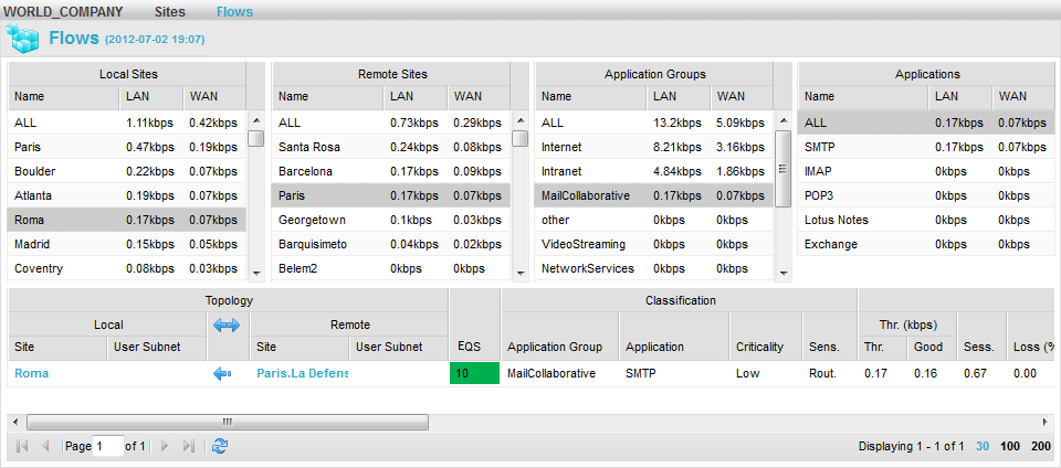

The flows in the chord diagram and in the detailed flows list can be filtered out by clicking on any filter or any combination of filters.
One can select several filters in a column by maintaining the CTRL key pressed during the selection. To select all filters between line A and line Z, select line A, press the SHIFT key and select line Z while maintaining the SHIFT key pressed.
Several filters from several columns can be applied simultaneously.
To remove the filters, click the first line (ALL; this is the default view).
Interactions between filters
When a filter is applied, the other filters are updated accordingly. For instance, if FTP is selected in the Application Groups filter, the Applications filter table only displays the applications belonging to that Group and the throughput values displayed in the Remote Sites filter correspond to the throughput for that Group only.

The following image illustrates how only MailCollaborative between Roma and Paris is shown in the flows list
