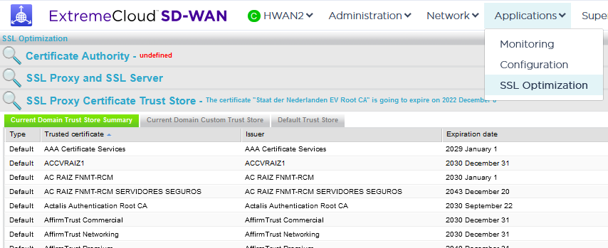

From the SD-WAN Orchestrator main menu, select Applications -> SSL Optimization.
Enabling SSL optimization requires a simple three-step configuration process on the SSL Optimization page.
This page contains three frames:
Certificate Authority to configure trusted proxy Certificate Authority credentials
SSL Proxy and SSL Server to select SSL proxy enabled sites and optimization enabled SSL servers
SSL Proxy Certificate Trust Store to customize the SSL Proxy Certificate Trust Store (optional)
To modify the parameters, click the Edit button at the top of the page. It is then displayed in Edition mode (indicated by a icon instead of the icon).
