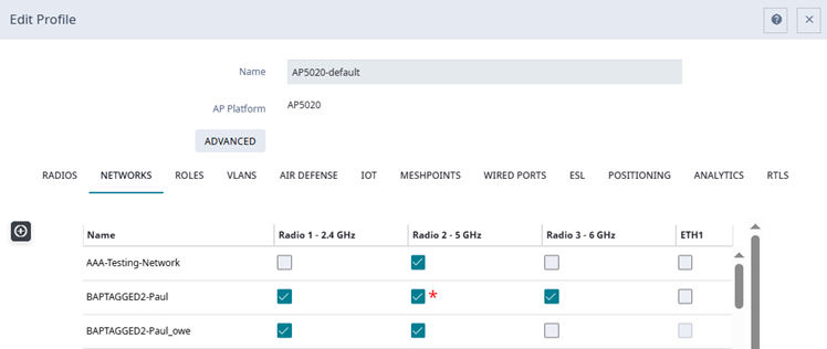

    You can configure 6GHz radios to advertise on the Open network. In this configuration, the network is not Open on 6 GHz radios, but instead they provide OWE encryption to devices that are OWE-capable. Follow these steps to configure 6 GHz radios to advertise on the Open network:
    1. Configure a WLAN with Auth Type set to Open.
    2. Enable this OWE Transition Auto Provisioning feature.
    3. Under Profile > Network Settings, select Radio 3 on the Open network.
