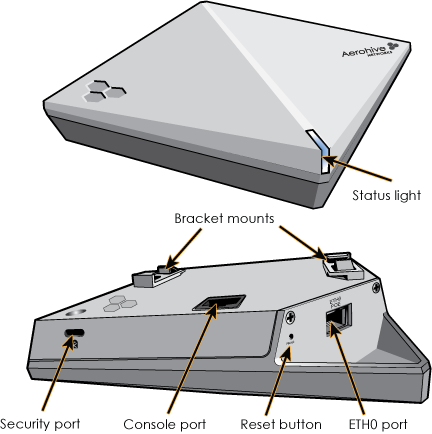

Hardware Components
You can see the hardware components of the AP130 in the illustration below and read about them in the sections that follow.
Component Descriptions
Status Light
The status light conveys operational states for system power, firmware updates, Ethernet and wireless interface activity, and major alarms. The AP130 has a status light bar on the top corner and down one side of the chassis. The colors of this light bar indicate the following states of activity:
Dark: There is no power or the status indicator is disabled.
Amber (flashing): This is an alert that indicates that the device is performing a firmware upgrade. Do not power off the device during this process.
Amber (steady): This is an alert that indicates that the CAPWAP connection has not been successfully established, or the device is booting or shutting down.
White: The device is powered on, a successful CAPWAP connection has been made, and the firmware is operating normally. During normal operation, the LED produces a slow blink consisting of 4 seconds of illumination followed by one minute of darkness. To extend the life of the status LED, turn it off completely for normal use, and turn it on when needed for troubleshooting.
To turn the LED on or off or change the brightness using the CLI, enter:
system led brightness [ bright | soft | dim | off ]
You can adjust the brightness level from bright (the default) to soft to dim, or turn it off completely in ExtremeCloud IQ. Navigate to Configure > Network Policy > Additional Settings > Network Service > Management Options. Turn Management Options on and scroll down to the System Settings section. Use the LED brightness drop-down to select the brightness level that you want.
When you change the brightness setting here, the new setting will apply to all devices under this network policy. To change the LED brightness for a single device, establish a console connection and use the CLI command.
For devices running HM Classic, you can set the LEDs for all APs on your network to blink or remain steady. Navigate toHome > Device Management Settings > LED Mode.
Console Port
Through the Console port, you can make a serial connection between your management system and the AP. When you connect to the device using the RJ45 Console port, the management station from which you connect to the device must have a VT100 emulation program, such as Tera Term Pro© (a free terminal emulator) or Hilgraeve HyperTerminal® (provided with Windows® operating systems from XP forward). The serial connection settings are: 9600 bits per second, 8 data bits, no parity, 1 stop bit, no flow control.
The pin-to-signal mapping for the Console port is shown in Extreme Device Pin Assignments.
Power Connector
You can power the AP130 through the ETH0 port from PSE (power sourcing equipment) that is compatible with the 802.3af and 802.3at standards. Because there is no on/off switch, these devices automatically power on when you connect them to power.
Ethernet Port
The AP130 has one RJ45 10/100/1000Base-T/TX Ethernet port (ETH0) that automatically negotiates half- and full-duplex connections with the connecting device. The port is autosensing and adjusts to straight-through and crossover standard Cat3, Cat5, Cat5e, or Cat6 Ethernet cables automatically. The AP receives PoE power through an Ethernet connection to the ETH0 port from PSE (power sourcing equipment) that is compatible with the 802.3at and 802.3af standards.
Power sourcing equipment can be embedded in a switch or router, or it can come from purpose-built devices that inject power into the Ethernet line en route to the AP. Because the PoE port has autosensing capabilities, the wiring termination in the Ethernet cable can be either straight-through or crossover.
You can purchase your own PoE injector or purchase the following PoE injectors as optional accessories from Extreme Networks (not available in Brazil):
Reset Button
You can use the Reset button to reset the device or restore the factory default settings. Insert a paper clip or similar tool into the Reset pinhole and press the button. To reboot the device, press the button for 5 seconds. To return the configuration to the factory default settings, press it for at least 10 seconds. After releasing the button, the indicator light goes dark, and then glows steady amber while the firmware loads and the system performs a self-test. After the software finishes loading and the AP has connected to ExtremeCloud IQ, the status indicator glows steady white.
To disable the reset button from resetting the configuration, enter this command: no reset-button reset-config-enable. When this command is enabled, pressing the button for 5 seconds will still reboot the AP, but pressing it for more than 10 seconds will not reset its configuration.
Antennas
The AP130 has four internal single-band antennas. All antennas are omnidirectional and provide fairly equal coverage in all directions.
Lock Slot
When mounting the AP on a ceiling track or flat surface, you can secure it to the track using a Kensington® lock in the lock slot or using the security screw and bracket that ships with the device.
