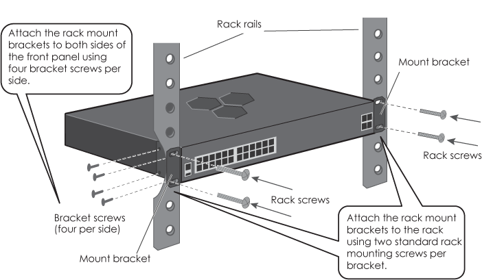

Install the SR2124P
Follow the safety guidelines in "Safety Guidelines" to ensure the safety of personnel and equipment when installing your device.
Install SR series switches on a clean, level desktop or surface, or in a standard equipment rack using the rack mount kit that ships with the switch, as shown below.

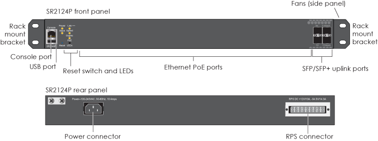

Hardware Components
You can see the hardware components for the SR2124P switch in the illustration below, and read about them in the descriptions that follow.

Console Port
Use the RJ45 Console port to make a serial connection between your computer and the switch to access the CLI.
The management station from which you connect to the device must have a VT100 emulation program, such as Tera Term Pro© (a free terminal emulator) or Hilgraeve Hyperterminal® (provided with Windows® operating systems from Windows 95 to Windows XP). The serial connection settings are: 9600 bits per second, 8 data bits, no parity, 1 stop bit, and no flow control.
For Console port pin assignments see Extreme Device Pin Assignments.
USB Modem Port
SR2124P switches can use a wireless USB modem for a WAN connection. The typical use of a USB modem is to act as a backup to the ETH0/WAN interface; however, for locations where an Ethernet connection to the WAN is not possible, you can use the USB modem as the primary (and only) interface to the WAN.

LEDs Mode Button
The LEDs mode button allows you to cycle through the port LED modes, (Link, Duplex, Speed, and PoE). To select a mode, press the LEDs button until the desired mode LED lights. The port LEDs then indicate the port status for that mode. See "Power, Ethernet Port, and SFP Port Status LEDs".
RPS Power Connector
SR2124P switches support the use of a redundant power supply for system backup. To order an RPS, contact your Extreme Networks representative
Reset Button
To reset the switch or restore factory default settings, insert a paper clip or similar tool into the pinhole and press the reset button. To reboot the device, hold the button down between 1 and 5 seconds. To return the configuration to the default settings, hold the button down for 5 seconds or longer. When you release the button, the status LED goes dark as the system reboots, then turns amber while the firmware loads and the system performs a self-test. After the firmware has finished loading and the switch has connected to ExtremeCloud IQ, the device status LED glows steady white.
Ethernet Ports
The SR2124P switch has 24 10/100/1000-Mbps Ethernet RJ45 LAN ports (ETH 1 through ETH 48). These ports are compatible with 10/100/100Base-T/TX and negotiate half and full duplex connections with the connecting device. The ports are auto-sensing and adjust to straight-through and crossover Ethernet cables automatically. All 24 ports supply 802.3at and 802.3af PoE/PoE+ to PSDs such as VoIP phones, wireless access points, and network cameras.

SFP Uplink Ports
Four SFP (small form pluggable) ports accommodate any combination of copper or fiber SFP and SFP+ modules (1 Gbps or 10 Gbps) for additional uplink capacity. SFP modules can be used to connect a broadband modem or other uplink device (such as a router, switch, or hub). SFP ports are typically used for capacity planning and to leverage the higher network bandwidth capabilities and speeds typically offered by SFP modules.
