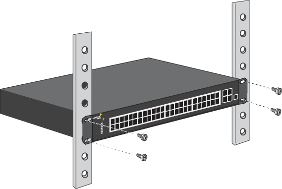

You can mount the SR2348P switch in any standard 19" (48 cm) equipment rack. These devices require 1 rack unit (RU) of space, which is 1.75" (44.45 cm) high. Use the following steps to mount the switch in a rack.
  1. Place one of the supplied brackets on the side of the switch so that the four holes of the bracket align with the screw holes on the switch. Use four screws to secure the bracket to the switch. The bracket measurements are shown here:
  1. Attach the other bracket in the same manner.
  2. When the brackets are securely attached, install the switch in the rack using two washers and two rack screws per side, as shown.

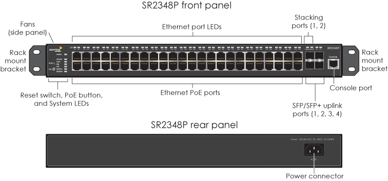

You can see the hardware components for the SR2348P switch in the illustration below, and read about them in the descriptions that follow.
Component Descriptions
LED Panel
Status LEDs and Ethernet LEDs are located on the left side of the front panel. Uplink port LEDs appear between the ports on the right side of the panel. For descriptions of the LEDs, see "Power, Ethernet Port, and SFP Port Status LEDs".
Reset Button
Use the Reset button to reboot the device or reinstate the default factory settings. Insert a paper clip or similar tool into the pinhole and press the button. To reboot the device, hold the button down between 1 and 5 seconds. To return the configuration to the default settings, hold the button down for 5 seconds or longer. When you release the button, the System LED goes dark as the system reboots, then turns amber while the firmware loads and the system performs a self-test. After the firmware has finished loading and the switch has connected to ExtremeCloud IQ, the System LED glows steady green.
PoE Button
The PoE button allows you to change the port LED modes between link status and PoE status. By default, the port LEDs are in link status (ACT) mode. Press the PoE button to see the PoE status for each port.
Ethernet Ports
The SR2348P switch has 48 10/100/1000-Mbps Ethernet RJ45 LAN ports (ETH 1 through ETH 48). These ports are compatible with 10/100/100Base-T/TX and negotiate half and full duplex connections with the connecting device. The ports are auto-sensing and adjust to straight-through and crossover Ethernet cables automatically.
PoE/PoE+Ports
PoE or PoE+ is supported on all 48 Ethernet ports to power PDs (powered devices) such as VoIP phones, wireless access points, and network cameras. The ports are IEEE802.3af and IEEE802.3at PSE (power sourcing equipment) compliant, as described here:
  • 802.3af PoE provides up to 12.95 W of DC power to each device (this rate reflects normal power loss through the cables). 802.3af meets the power demands of PoE Class 0, 1, 2, and 3 devices.
  • 802.3at PoE+ provides up to 25.5 W of DC power to each device (this rate reflects normal power loss through the cables). 802.3at meets the power demands of PoE Class 4 devices.
802.3af is the default setting for all ports, but you can configure all 48 ports for PoE (803.2af) or 24 ports for 802.3at, as long as you do not exceed the PoE power budget (740 W).
To change the power setting, first add 803.2af and 802.3at PSE profiles to your network policy in ExtremeCloud IQ and assign them to ports as needed. You can change the profile at any time. For more information see "PoE Power Management".
The Ethernet port pin assignments use the TIA/EIA-568-B standard. The ports accept standard Cat3, Cat5, Cat5e, or Cat6 Ethernet cable, and autosensing capabilities allow the wiring termination in the Ethernet cable to be either straight-through or crossover.
Port Priority
By default, all ports have priority enabled, with a setting of low. There are three port priorities: low, high, and critical. If there is no priority setting applied to a port, or if multiple ports have the same priority, the switch gives the port with the lowest number the higher priority.
You can assign and change port priorities through the PSE port profiles that you create and assign to your network policies in ExtremeCloud IQ.
SFP/SFP+ Uplink Ports
For additional uplink capacity, The SR2348P has four 10 Gbps uplink ports that accommodate SFP and SFP+ modules. SFP uplink ports are typically used for capacity planning, and to leverage the higher network bandwidth capabilities and speeds typically offered by SFP modules to connect to uplink devices such as broadband modems, routers, switches, or hubs. For information about installing, replacing, and maintaining SFP modules, see "Working with SFP Modules".
You can order SFP and SFP+ modules from Extreme Networks, or purchase your own modules, For more information, contact your Extreme Networks representative.
Power Connector

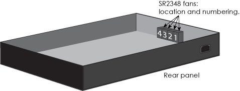

Fans
The four cooling fans are located on the right side panel of the device (when facing the front panel). The fans are numbered 1-4, with fan 1 being closest to the front panel.
Display Fan and Temperature Status using CLI Commands
To display the current status of the fans, enter the following command:
show system fans
To display the current system temperature, enter the following command:
show system temperature
View Fan Status in ExtremeCloud IQ
To view fan status in ExtremeCloud IQ, navigate to Manage > Devices. Select the check box for a the name of a switch. A page appears that shows system information for the switch. Scroll down to the System Details section. The temperature and fan status appear at the bottom of this section.
The fans are numbered in order from front to back of the unit, as shown.
