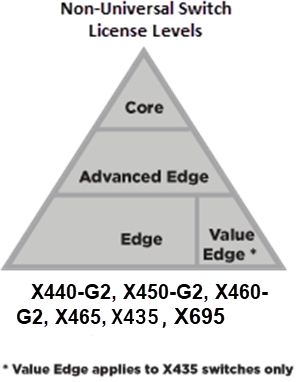

The limits data is grouped by license level that contains the associated features:
Non-universal switches include the following license levels:
Switch CategorySwitchesApplicable License Levels
Non-universal switchesX435 *, X440-G2, X450-G2, X460-G2, X465, X590, X620, X690, X695Value Edge *, Edge, Advanced Edge, Core
Note: * The X435 is the only switch that supports the Value Edge license level.
The following figure illustrates that each license level builds on the features of the license level below it. For example, the Advanced Edge license includes all of the features in the Edge license, plus the features in the Advance Edge license level.
License Levels for non-Universal Switches
license levels
