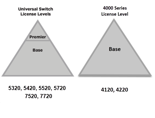

The limits data is grouped by license level that contains the associated features:
The Universal family of switches includes two license levels: Base and Premier.
The following figure illustrates that each license level builds on the features of the license level below it. For example, the Premier license includes all of the features in the Base license, plus the features in the Premier license level.
License Levels for Universal Switches
license levels
