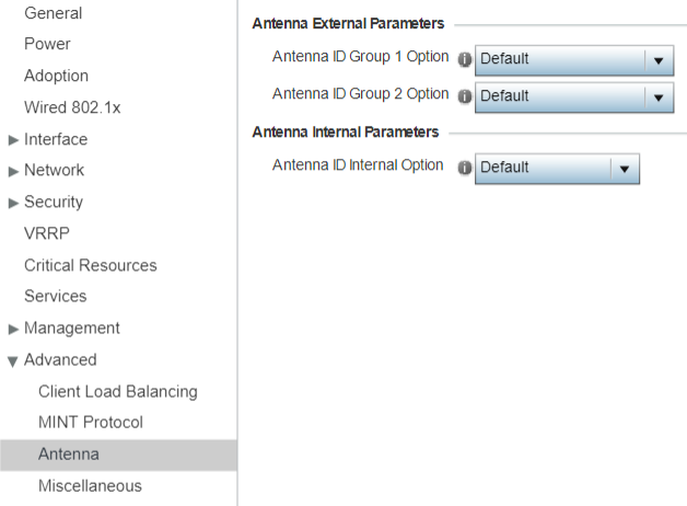

  1. Select Configuration → Devices → Device Configuration.
  2. Select the target AP510e/AP560h device.
    The selected device's configuration menu is displayed.
  3. Expand the Advanced menu and select Antenna.
    Advanced Device Overrides - Antenna Screen
  4. In the Antenna External Parameters section, configure the following AP510e antenna-id settings:
    Antenna ID Group 1 Option Use this drop-down menu to configure the antenna type used in the antenna ports 1 to 4 (group-1 antennas).
    The antenna types supported for 'group-1' and 'group-2' antenna ports are: ai-dq04360s, ml-2452-apa2-01, ml-2452-apa2-02, ml-2452-hpa5-036, ml-2452-hpag4a6-01, ml-2452-hpag5a8-01, ml-2452-pna5-01r, ml-2452-pna7-01r, ml-2452-pta4m4-036, ml-2452-sec6m4-036, ws-ai-dq05120.
    The default setting is 'Default', that is no antenna-type associated with the group-1 antenna ports and the radio is disabled.
    Note: Group-1 antenna configuration is required for all three software modes.
    Note: Refer to the table above for the supported software modes and the corresponding antenna configurations.
    Antenna ID Group 2 Option Use this drop-down menu to select the antenna-id used in the antenna ports 5 to 8 (group-2 antennas).
    The default setting is 'Default', that is no antenna-type associated with the group-2 antenna ports and the radio is disabled.
    Note: Group-2 antenna configuration is ONLY required for software mode 3.
  5. AP560h antenna-id configuration
  6. In the Antenna Internal Parameters section, configure the following AP560h antenna-id settings:
    This option is visible only if the profile-type selected is for AP560. This configuration is needed only if the target device-type is AP560h
    Antenna ID Internal Option Use this drop-down menu to configure the internal antenna mode. The options are:
    • Default - This is the default setting. In the default setting, no antenna-mode is associated and the radio is disabled. Select either one of the following options to turn-on the radio.
    • internal-560h-30 - Sets the mode as 30 degree.
    • internal-560h-70 - Sets the mode as 70 degree.
  7. Click OK to save the changes made to the profile's advanced antenna configuration.
