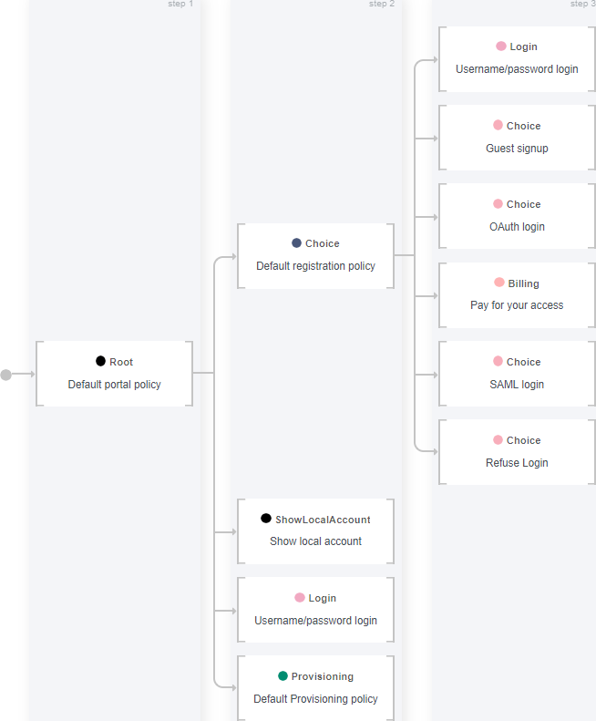

Menu path: Configuration > Advanced Access Configuration Overview > Portal Modules.
The Portal Modules page lists the elements used to construct CWPs for Connection Profiles. The theory behind CWP modules is described in Captive Web Portal.
The display is a pictorial representation of the connections and flow between portal modules. New root modules are listed across the top of the page.
The underlined root module (Default portal policy in this case) is displayed below.
The root of the tree on the left, in the box labeled step 1. Additional steps in the portal module are shown connected to its right. Each box can be edited by clicking on the box to reveal an edit and delete button.
Selection of the first symbol allows the entry to be edited. Existing modules are displayed at the bottom of the screen by category.
Items are chosen from these categories and placed in steps 1, 2, or 3. As a module is moved over the display arrows appear to indicate where the module can be legally placed.
New Root modules are created by selecting

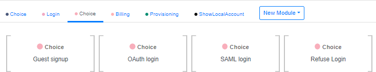

Other modules are created by clicking
at the
bottom of the page. The choices by category are:
Root modules occupy the top of the CWP display tree and can reference any other module, although Chained and Choice modules are most often used. The Root module operates in the same manner as a Chained module. It is a simple container that defines all the modules that are used in a sequential manner to the user. Network access is allowed after the client has completed all modules contained in the Root, .
The fields in this module's definition are:

Choice modules are used to offer users a set of authentication choices or chained modules. The fields in this module's definition are:
| Field | Usage | Example |
| Name | A name used to identify the module. The ID can only include alphanumeric characters, dashes, and underscores. | multiple_auth_chain |
| Description | A description that accompanies the ID. | Oauth then SMS |
| Show First Module when None are Selected | If enabled, if the client selects none of the choices, then the first one will be used. |
| Mandatory fields | The information fields that the user must fill in for the authentication. | |
| Fields to Save | A list of fields that will be saved throughout the registration process. | firstname lastname |
| Template | The name of the template used to frame the page. | content-with-choice.html |
