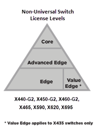

Non-universal switches include the following license levels:
| Switch Category | Switches | Applicable License Levels |
| Non-universal switches | X435 *, X440-G2, X450-G2, X460-G2, X465, X590, X620, X695 | Value Edge *, Edge, Advanced Edge, Core |
Note: * The X435 is
the only switch that supports the Value Edge license
level.
The following figure illustrates that each license level builds on the features of the license level below it. For example, the Advanced Edge license includes all of the features in the Edge license, plus the features in the Advance Edge license level.
For more information about licenses, see ExtremeXOS 32.4 Feature License Requirements .
