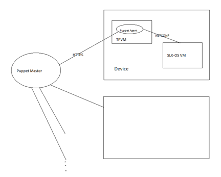

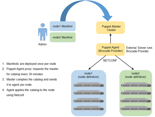

In the Agent/Master architecture, a Puppet master server controls important configuration information and manages agent nodes requests for configuration catalogs. Periodically, a Puppet agent sends facts to the Puppet master and requests a catalog. The master compiles and returns the node‘s catalog. There are two ways of integration with Puppet agent/master architecture.
We support a hybrid Puppet setup which allows the provider to run on a Puppet agent installed by the customer on the TPVM. NETCONF is used as the API to communicate from the TPVM to the SLX-OS VM in the Extreme device.

Puppet can also run in a stand-alone architecture, where each managed server has its own complete copy of the configuration, and it compiles its own catalog. The managed nodes run the Puppet apply application, as a scheduled task/cron job (or on demand for initial configuration for smaller configuration tasks).
The following illustration depicts how the major Puppet components interact.

Puppet master In a standard Puppet client-server deployment, the server is known as the master. The Puppet master controls the data center configuration. The puppet master serves configuration catalogs on demand to the puppet agent service that runs on the clients. The master uses an HTTP server to provide catalogs. The master can reside in any location, but the master must have connectivity to the agents. The master contains the Puppet-language file or files known as manifests.
Agent Puppet agents are Puppet client daemons that receive their configuration information from the Puppet master. A computer running the puppet agent is called an agent node. The Agent nodes must have connectivity to both the Puppet Master and to the Extreme node cluster or clusters it is configuring.
Extreme Provider Extreme Providers implement resource types on a specific type of system, using the system's own tools. The Extreme Provider executes the manifests for the purpose of configuring the associated node cluster(s) and switches. The Extreme Provider uses NETCONF calls to configure the switch or switches. These Netconf calls are transparent to the Puppet administrator and user. In general, providers are simple Ruby wrappers around shell commands, so they are usually short and easy to create. Instructions are given later in this chapter and where to obtain the Provider and run it on the Puppet Master.

Main steps for using Puppet
The main steps needed to employ Puppet in your environment are:
  1. Determining where you want the Puppet master to reside. This can be a server in any location.
  2. Determining which node or nodes you want to be Agent nodes. The Agent nodes must have connectivity to both the Puppet Master and the Extreme node cluster or clusters that you want the Agent node to configure.
  3. Installing the Extreme Provider on the Puppet Master.
  4. Setting up the site manifest file.
  5. Writing one manifest for each node cluster that you want to manage by means of Puppet.
  6. Placing the manifest(s) on the Master Puppet server.

If you are using Puppet to manage resources, the properties that you configure with Puppet can be changed by using the command line interface (CLI). However, if any such properties are changed from the CLI, the Puppet-managed settings go back into effect when the script is run. This takes place either every 30 minutes (automatically) or when you manually run the script. If you want to change the 30-minute proxy-request interval, you can change the run interval property of the main configuration file. For more information, refer to https://docs.puppetlabs.com/puppet/latest/reference/config_file_main.html.
