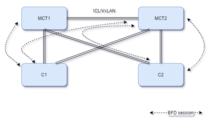

BFD over MCT and VxLAN topology
Data flows between client 1 and MCT 1, client 2 and MCT 1, client 1 and MCT2, client 2 and MCT2, and, over ICL or VxLAN, between MCT1 and MCT 2
