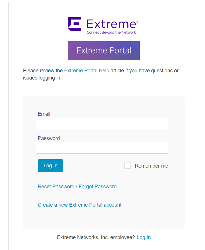

  1. Log in to the Extreme Portal at https://extremeportal.force.com/ExtrLicenseLanding.
  2. If you do not have an Extreme portal account, select Create a new Extreme Portal account.
    The following figure shows the Extreme Portal login window.
    Extreme portal login window

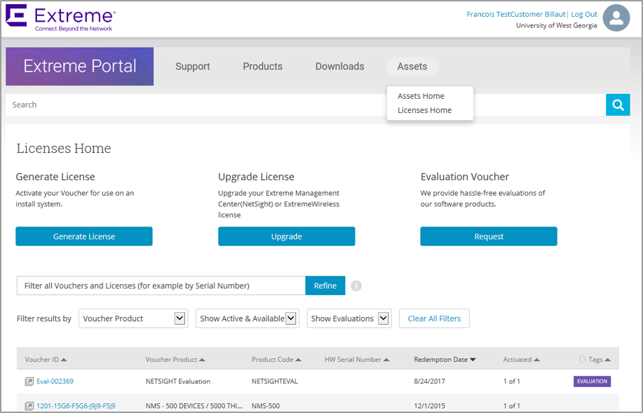

  3. Enter your email and password. Click Log In.
    The Licenses Home window appears.
  4. Select Assets > Licenses Home option. Click Generate License.
    The Generate License window is displayed.

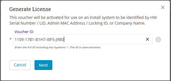

  5. Enter the VID. Click Next.
    The VID has 20 alphanumeric characters with hyphens.

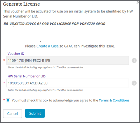

  6. Enter the unique identifier of the HW (or the serial number of the LID). Click Submit.
    You must check the box to agree to the Terms and Conditions.
    HW serial number window

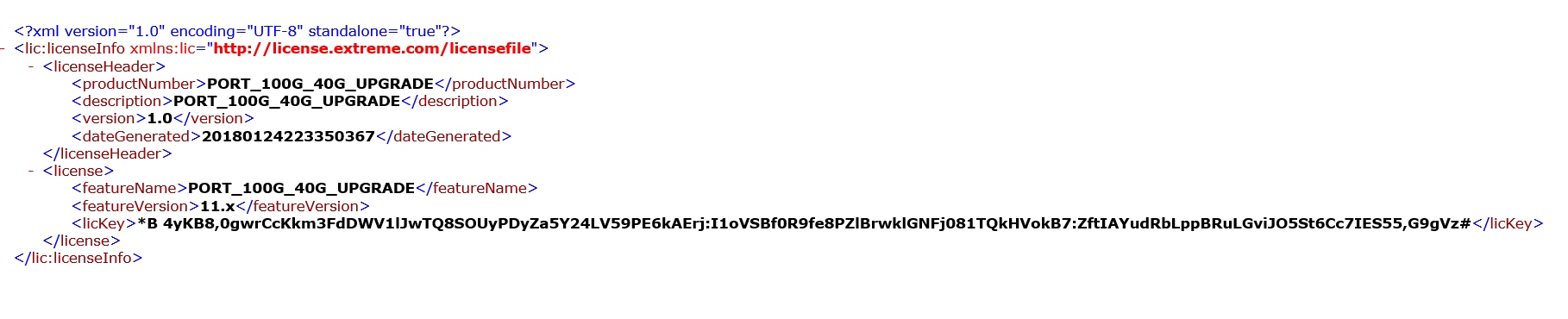

    In example below, the contents of the XML license are displayed, including the license SKU and license keys.
    License file window
