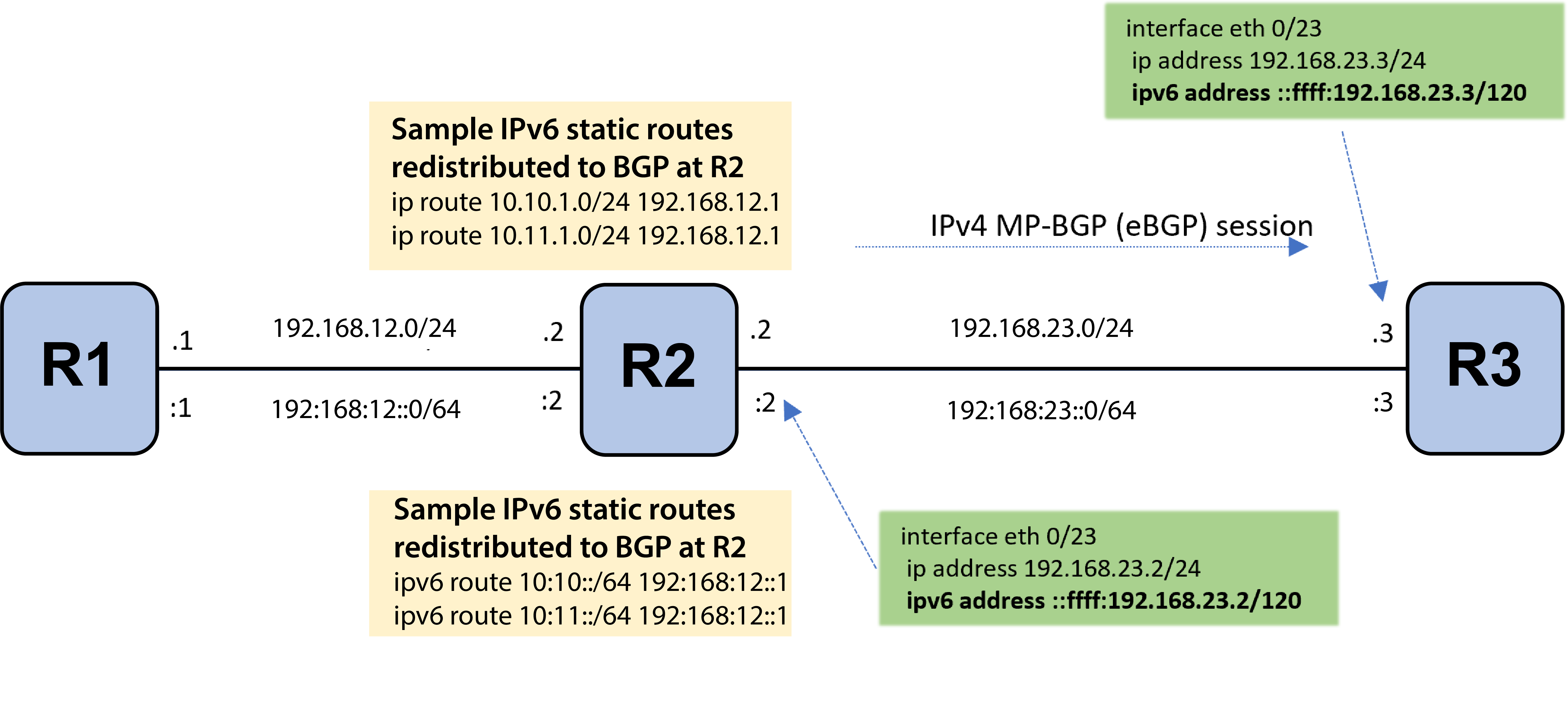

In the above example, the configuration that must be applied to the interface, on which the eBGP session is to be enabled, is shown in the green box.
This is the consolidated configuration on the interface on which eBGP (MP-BGP) is configured. The interface is configured to use the user vrf vrf2.
interface Ethernet 0/23 vrf forwarding vrf2 ip address 192.168.23.2/24 ipv6 address ::ffff:192.168.23.2/120 no shutdown
