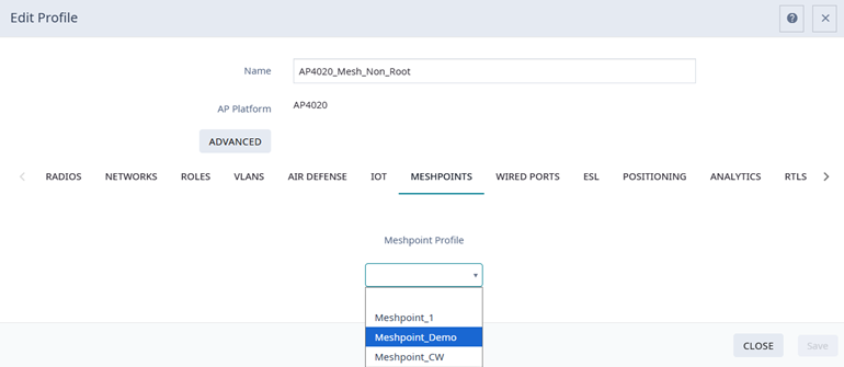

  1. On the Edit Profile page under the Meshpoints tab, select the target Mesh Network from the Meshpoint Profile drop-down list.

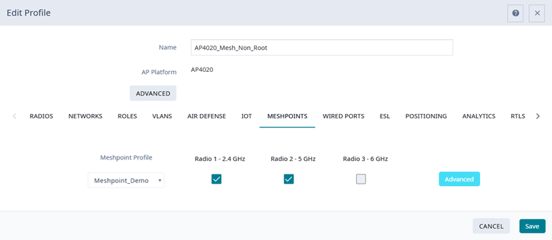

  2. Assign the Meshpoint Profile to one or more radios by selecting the check box associated with the radio.
    The access points are limited to one meshpoint. Multiple radios can be configured for a single meshpoint.
    How channels, widths, and power are applied to meshpoint radios is described in Meshpoint Radio RF Policy Assignment and Configuration.
  3. Select Advanced.

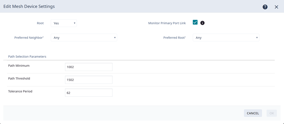

    The Edit Mesh Device Settings dialog opens.
  4. Configure the following settings, in accordance with the AP model type.

    Wi-Fi 6 or higher standardRoot
    Note: AP models using Wi-Fi 6 or higher standard can be part of the same mesh network, but they cannot participate in a mesh network with AP39xx models. AP39xx access points must be a separate mesh network from the Wi-Fi 6 and higher standard APs.
    A root meshpoint is defined as a meshpoint that is connected to the WAN and provides a wired backhaul to the network. Select the root behavior of this meshpoint.
    • Yes — Meshpoint is root node for this mesh network.
    • No — Meshpoint is not a root node for this mesh network. (Additional settings display.)
    Wi-Fi 6 or higher standardMonitor Primary Port Link(Available for root APs) With Monitor Primary Port Link enabled, if a root AP loses connection to the backhaul, the non-root APs scan for a new root AP and the original root performs service as a non-root AP. When the original root AP restores connectivity, it resumes the role of root AP. Through the use of Automatic Channel Selection (ACS), the optimum path is restored.
    Wi-Fi 6 or higher standardPreferred Neighbor(Available for non-root APs) Select the preferred Neighbor (AP name and radio) from a list of APs with a root or non-root mesh radio.
    When a non-root AP can see mesh beacons from more than one neighbor, this setting configures the AP to prefer one beacon over all others when choosing a path back to the root.
    Wi-Fi 6 or higher standardPreferred Root(Available for non-root APs) Select the preferred root AP from a list of APs with a root mesh radio. Use this setting to balance the number of meshpoints reporting to a specific root AP.
    Radio Settings
    Note: Dual-band support is available with Meshpoint. When one radio is configured for Meshpoint, both radios can provide service.
    Radio settings for the root-AP and non-root APs must match.
    Wi-Fi 6 or higher standardChannel WidthRepresents the desired channel width. The channel width is set for all APs in a device group. Available options include:
    • Auto – Channel width is calculated automatically by the AP. It is displayed in the user interface for informational purposes only.
    Note: Path Minimum and Path Threshold are settings that refer to values in the Mesh Route Table. They are metric values determined by an algorithm that indicate when ACS scans for a better meshpoint radio channel.
    The best route path algorithm includes elements such as hop count, data rates, RSSI, and loss rate. A perfect score is 1179.
    Wi-Fi 6 or higher standardPath MinimumThe minimum root path metric value is used to evaluate the channel during the Mesh ACS scan process. Only the meshpoint with a root path metric less than the minimum root path is considered a candidate meshpoint that can hop to the meshpoint root.
    Valid values are 100-20000. Default value is 1000. The lower metric value indicates a better quality mesh link to the root.
    Wi-Fi 6 or higher standardPath ThresholdThe maximum root path metric value that determines when to evaluate the meshpoint radio channel for a better path to the gateway. When the current path metric value exceeds this threshold, an ACS scan is triggered on the meshpoint. Valid values are 800-65535. Default value is 1500. Setting this value below 1500 will result in more frequent channel scans.
    Wi-Fi 6 or higher standardTolerance Period
    This is a buffer period (in seconds) between when the metric value exceeds the Path Threshold and the scan begins. Set the number of seconds to allow the root path metric to recover before a scan begins.
    Valid values are 10-600. Default value is 60.
    AP39xxRoot
    • Yes - Meshpoint is root node for this mesh network.
    • No - Meshpoint is not a root node for this mesh network.
    AP39xx OnlyPath Selection MethodSelect the method used for path selection in a mesh network. Available options include:
    • Uniform – The path selection method is uniform (two paths are considered equivalent if the average value is the same for these paths). Use this method for regular infrastructure meshing.
    • SNR-Leaf – Use this method in special infrastructure cases when it is more desirable to make path decisions based on SNR than on metric values.
    AP39xx OnlyHysteresis Minimum Threshold This is the minimum SNR value to consider a candidate for the next hop in a dynamic mesh network. For the AP39xx, this value maps to the Roaming Threshold value.
    • 100dB to 85dB maps to Low
    • 84dB to 70dB maps to Medium
    • 69dB to 0dB maps to High
  5. Select OK to close the window and return to the Meshpoints tab, then select Save to commit the settings.
