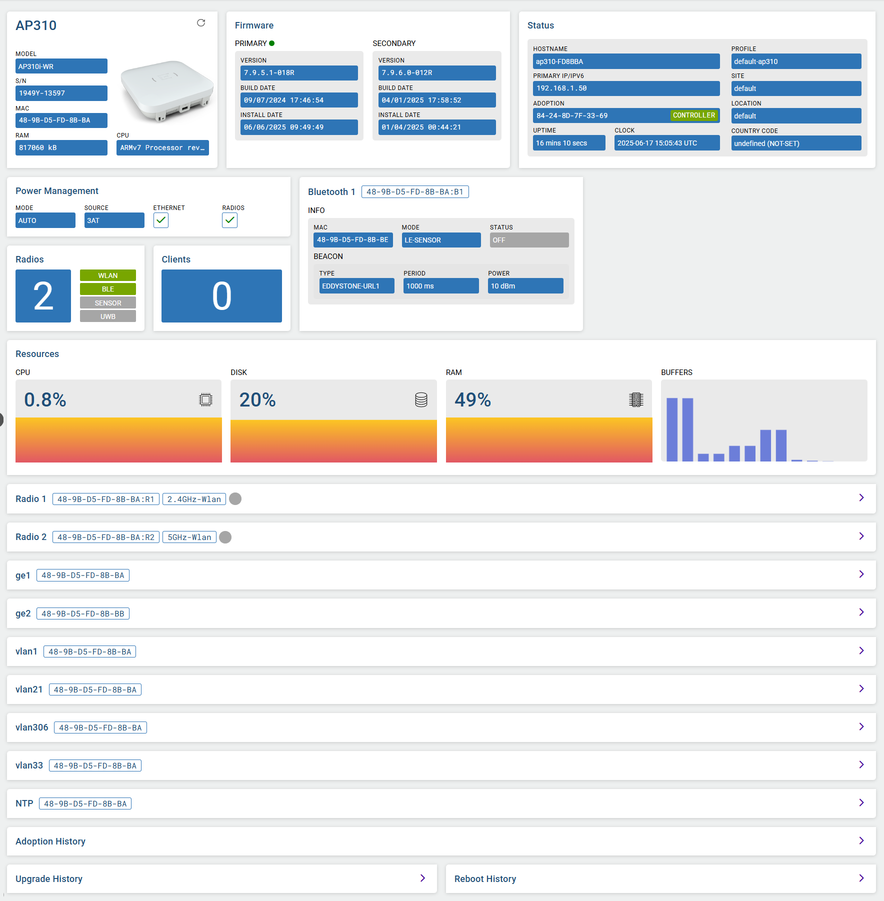

Access Point Statistics
Example of Device Statistics Display for APs shows an example of a device statistics display for APs.
Access Point (AP) statistics are arranged under the following panes (left-to-right, top-to-bottom):

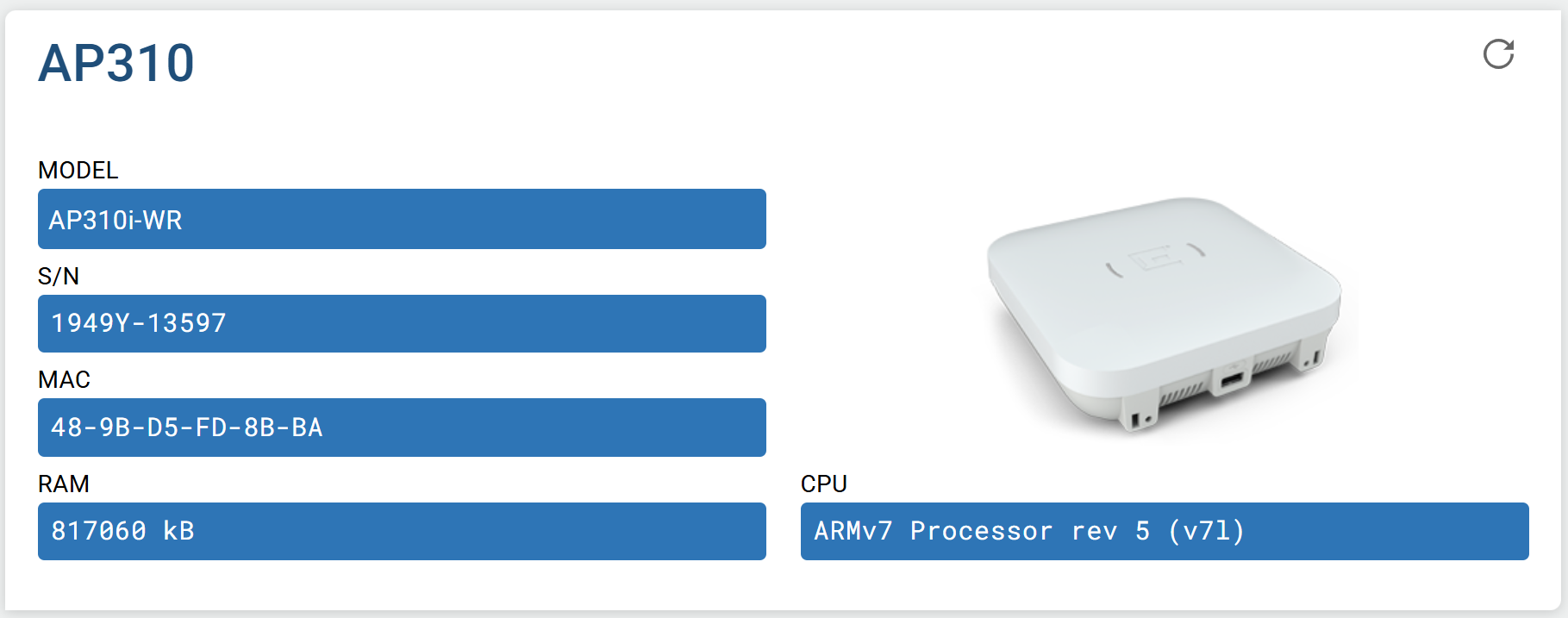

Device Information
AP Statistics – Example Device Information Display shows an example of device information displayed for APs in the RF Domain.
Select to refresh the display.
AP Statistics – Device Information Description describes the information displayed.
Table 1. AP Statistics – Device Information Description
FieldDescription
TypeThe AP type is displayed in the upper–left position of the pane.
ModelDisplays the model of the selected AP to distinguish its exact SKU and country of operation.
S/NDisplays the serial number of the AP.
MACDisplays the MAC address of the AP. This is factory assigned and cannot be changed.
RAMDisplays the free memory available with the RAM.
CPUDisplays the processor core.

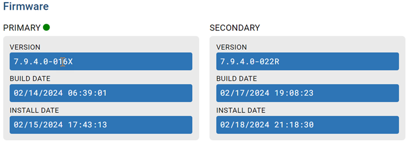

Firmware
AP Statistics – Example Firmware Information Display shows an example of device firmware information displayed for APs in the RF Domain.
You can store both a Primary and Secondary firmware version in memory. An automatic fallback mechanism exists, which loads the Secondary version if the Primary version fails. A appears adjacent to either Primary or Secondary, indicating which firmware is currently in use.
AP Statistics – Firmware Information Description describes the information displayed.
Table 2. AP Statistics – Firmware Information Description
FieldDescription
VersionDisplays the software (firmware) version on the AP. Use this information to assess whether a firmware upgrade would enhance the AP's support capability.
Build DateDisplays the date on which the firmware version build was created.
Install DateDisplays the date on which the firmware was installed on the AP.

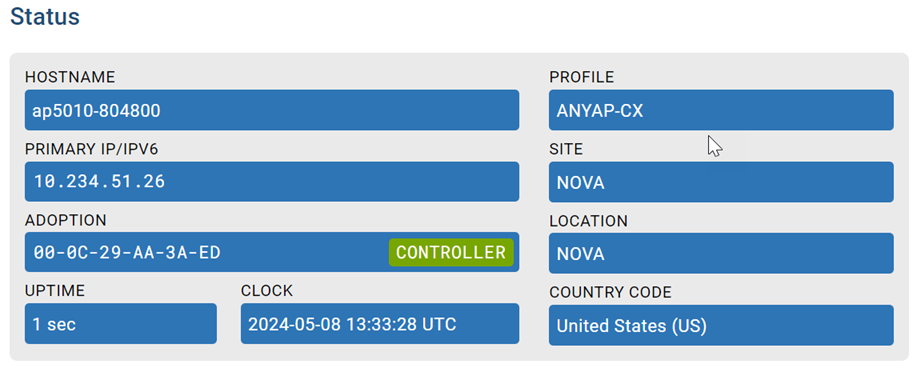

Status
AP Statistics – Example Device Status Display shows an example of device status information displayed for APs in the RF Domain.
AP statistics – Device Status Information Description describes the information displayed.
Table 3. AP statistics – Device Status Information Description
FieldDescription
HostnameDisplays the unique administrator-assigned name of the AP.
ProfileIdentifies the Profile that has been assigned to the AP.
Primary IP/IPv6Displays the IPv4 or IPv6 address assigned to the AP either through DHCP or through static IP assignment.
SiteDisplays the RF Domain name of which the AP is a member. Unlike a controller or service platform, an AP can belong to one RF Domain only, based on its model.
AdoptionIdentifies the MAC address of the controller to which the AP has been adopted.
LocationDisplays the geographical location of the Site (RF Domain), if it is configured. If this parameter is not configured, the Site name appears in this field by default.
UptimeDisplays the cumulative time since the AP was last rebooted or lost power.
ClockDisplays the date, time, and time zone of system clock.
Country CodeDisplays the country code assigned to the AP.

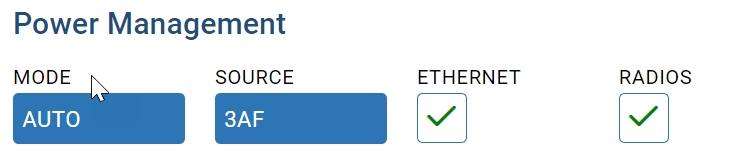

Power Management
AP Statistics – Example Power Management Display shows an example of power management information displayed for APs in the RF Domain.
AP Statistics – Power Management Statistics Description describes the statistics displayed.
Table 4. AP Statistics – Power Management Statistics Description
Field/Check boxDescription
Mode
Displays the configured Power Management mode. Possible modes include:
  • Automatic
  • 802.3af
  • 802.3at
  • 802.3bt
See Power Configuration for a description of these modes and their function.
SourceDisplays the power mode currently invoked by the selected AP.
Ethernet
Displays the AP's Ethernet port status, as follows:
  • : enabled
  • : disabled
Radios
Displays the AP's radio power status, as follows:
  • : enabled
  • : disabled
Each AP radio is capable of having a unique, administrator-defined power transmission setting.

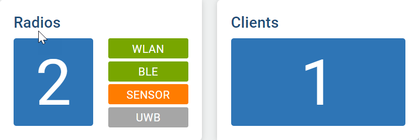

Radios and Clients
AP Statistics – Example Radios and Clients Displays shows an example of radio and client statistics displayed for APs in the RF Domain.
AP Statistics – Radios and Clients Statistics Description describes the information displayed.
Table 5. AP Statistics – Radios and Clients Statistics Description
ElementDescription
RadiosDisplays the total number of radios configured on the AP and their assignments: WLAN, BLE, Sensor, or UWB.
ClientsDisplays the total number of clients connected to the AP.

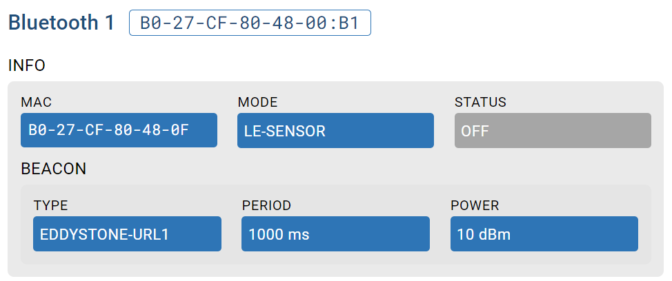

Bluetooth
AP Statistics – Example Bluetooth Radio Display shows an example of Bluetooth radio information displayed for APs in the RF Domain.
AP Statistics – Bluetooth Radio Information Description describes the information displayed.
Table 6. AP Statistics – Bluetooth Radio Information Description
FieldDescription
Bluetooth 1Displays the system-assigned Bluetooth radio name, consisting of the AP's MAC address and the radio number.
MACDisplays the factory-set, hard-coded MAC address for the AP's Bluetooth radio.
Mode
Indicates the current Radio Mode setting for the Bluetooth radio. Possible modes displayed are:
  • bt-sensor
  • le-beacon
  • le-sensor
  • le-dual
See Manage Bluetooth Configuration for details about these mode types and their function.
StatusDisplays the current operational status of the Bluetooth radio: either On or Off.
Type
Identifies the transmission pattern currently configured for the Bluetooth radio beacon. Possible pattern types include:
  • eddystone-url1
  • eddystone-url2
  • ibeacon
See Manage Bluetooth Configuration for details about these pattern types and their function.
PeriodDisplays the configured Bluetooth radio‘s beacon transmission period (100 – 10,000 milliseconds).
PowerDisplays the current power level the radio is using for transmissions.

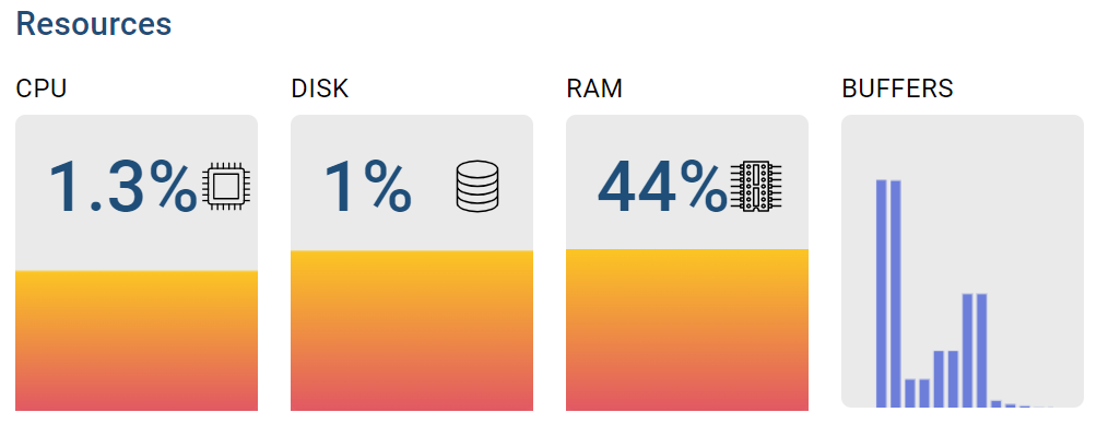

Resources
AP Statistics – Example Resources Display shows an example of Resources information displayed for APs in the RF Domain.
AP Statistics – Resources Information Description describes the information displayed.
Table 7. AP Statistics – Resources Information Description
ResourceDescription
CPU
Displays the percentage of total available CPU currently in use.
Disk
Displays the percentage of total available disk space currently in use.
Hover over the colored area to view a pop-up detailing current disk usage in megabytes (MB).
RAM
Displays the percentage of total available RAM currently in use.
Hover over the colored area to view a pop-up detailing current memory usage in megabytes (MB).
Buffers
Displays the current buffers available to the AP.
Hover over the bar graph lines to view a pop-up detailing buffer size, current utilization, and buffer limit.

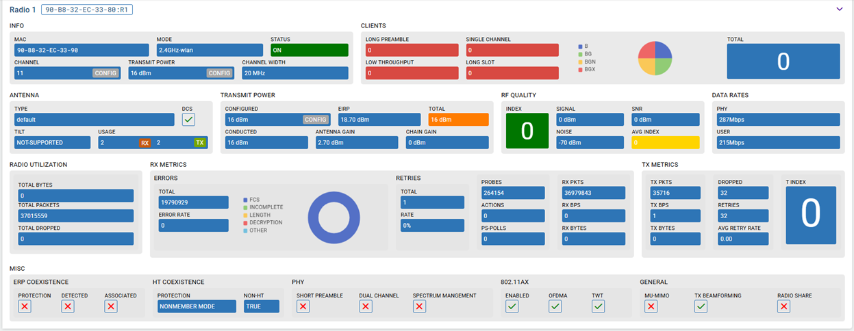

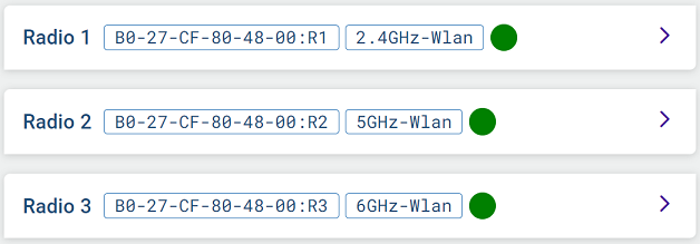

Radios
AP Statistics - Radios Information Display and AP Statistics - Radios Detailed Display show examples of Radio information displayed for APs in the RF Domain.
Select associated with a radio to view further detail.

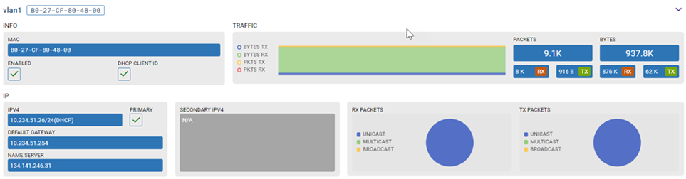

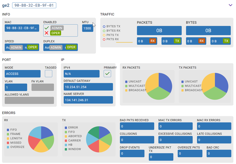

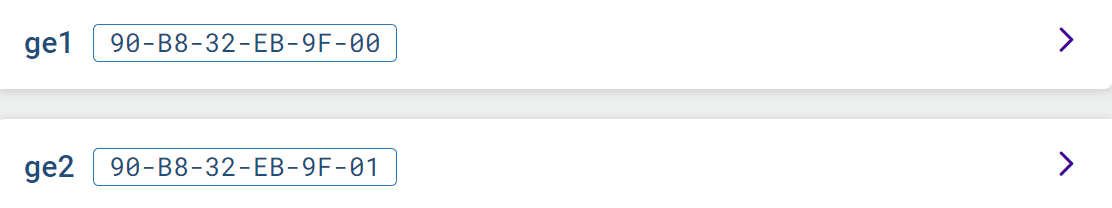

GbE Ports
AP Statistics – Example GbE Port Information Display and AP Statistics – Example GbE Port Details Display show an example of Gigabit Ethernet port information displayed for APs in the RF Domain.
Select associated with a GbE port to view further detail.
AP Statistics – GbE Port Information Description describes the information displayed in the preceding figures.
Table 8. AP Statistics – GbE Port Information Description
ElementDescription
GbE PortDisplays the Gigabit Ethernet port name (geX) and interface MAC address.
Info
MACDisplays the interface MAC address.
Enabled
Indicates the interface status, as follows:
    • interface ADMINistrative status = Enabled
    • interface OPERational status = Up
    • interface ADMINistrative status = Disabled
    • interface OPERational status is Down
MTUIdentifies the largest IPv6-formatted packet size that can be sent over this interface.
SpeedDisplays the configured interface speed and the actual operating speed, as follows:
  • Admin: Displays the configured maximum speed (in Mbps) at which the port can transmit or receive. This value can be either 10, 100, 1000 or Auto. Auto indicates the speed is negotiated between connected devices.
  • Oper: Displays the current speed of the data transmitted and received over the interface.
DuplexDisplays the configured duplex setting and the actual duplex setting in use, as follows:
  • Admin: Displays the configured Duplex setting for the interface. This value can be either Auto, H (half duplex), or F (full ). Auto indicates the duplex mode is negotiated between connected devices.
  • Oper: Displays the current operating Duplex mode of interface as either H (half duplex) or F (full duplex).
Traffic
Packets
RX PKTS: Displays the number of good packets received.
TX PKTS: Displays the number of good packets transmitted.
Bytes
RX Bytes: Displays the number of octets (bytes) with no errors received by the interface.
TX Bytes: Displays the number of octets (bytes) with no errors sent by the interface.
Port
ModeThe Mode can be either of the following:
  • Access: This Ethernet interface accepts packets only from the native VLANs.
  • Trunk: This Ethernet interface allows packets from a list of VLANs you can add to the trunk.
Tagged
Indicates whether the VLAN is tagged, as follows:
  • : means the native VLAN is tagged.
  • : means the native VLAN is untagged.
VLANDisplays the tag assigned to the native VLAN (if mode is Trunk) or the access VLAN (if mode is Access).
FA VLANDisplays the tag assigned to the Fabric Attach (FA) client VLAN (if mode is Access).
Allowed VLANsDisplays the VLANs that exclusively send packets over the port (if mode is Trunk).
IP
IPv4Displays the IP address of the interface.
PrimaryThe presence of a check mark indicates that the IP address is assigned to this interface either through DHCP or through static IP assignment.
Default GatewayDisplays the Default Gateway's IP address. This is the gateway used to route traffic to the specified network.
Name ServerDisplays the names of the servers designated to provide DNS resources to this access point.
RX PacketsDisplays the number of multicast/unicast/broadcast packets received through the selected GbE interface in a pie chart.
TX PacketsDisplays the number of multicast/unicast/broadcast packets sent through the selected GbE interface in a pie chart
Errors
RXDisplays RX Errors in a pie chart, as follows:
  • FIFO Errors: Displays the number of FIFO errors received at the interface. First-In First-Out queueing is an algorithm that involves buffering and forwarding of packets in the order of arrival. FIFO entails no priority for traffic. There is only one queue, and all packets are treated equally.
  • Frame Errors: Displays the number of frame errors received at the interface. A frame error occurs when a byte of data is received, but not in the format expected.
  • Length Errors: Displays the number of length errors received at the interface. Length errors are generated when the received frame length was less than (or exceeded) the Ethernet standard.
  • Missed Errors: Displays the number of missed packets. Packets are missed when the hardware received FIFO has insufficient space to store the incoming packet.
  • Oversize Errors: Displays the number of overflow errors. An overflow occurs when packet size exceeds the allocated buffer size.
TXDisplays TX Errors in a pie chart, as follows:
  • Error: Displays the number of packets with errors transmitted on the interface.
  • FIFO: Displays the number of FIFO errors received at the interface. Firstin-First-Out queueing is an algorithm that involves the buffering and forwarding of packets in the order of arrival. FIFO entails no priority for traffic. There is only one queue, and all packets are treated equally.
  • Aborted: Displays the number of packets aborted on the interface because a clear-to-send request was not detected.
  • Carrier: Displays the number of carrier errors on the interface. This generally indicates bad Ethernet hardware or cabling.
  • Heart Beat: Displays the number of heartbeat errors. This generally indicates a software crash or packets stuck in an endless loop.
  • Window Errors: Displays the number of window errors transmitted. TCP uses a sliding window flow control protocol. In each TCP segment, the receiver specifies the amount of additional received data (in bytes) in the receive window field the receiver is willing to buffer for the connection. The sending host can send only up to that amount. If the sending host transmits more data before receiving an acknowledgment from the receiving host, it constitutes a window error.
Bad Pkts ReceivedDisplays the number of bad packets received through the interface.
MAC TX ErrorsDisplays the number of transmits that failed because of an internal MAC sublayer error that is not a late collision, excessive collision count, or a carrier sense error.
MAC RX ErrorsDisplays the number of received packets failed because of an internal MAC sublayer that is not a late collision, excessive collision count, or a carrier sense error.
CollisionsDisplays the number of collisions on the interface.
Excessive CollisionsDisplays the number of excessive collisions. Excessive collisions occur when the traffic load increases to the point that a single Ethernet network cannot handle it efficiently.
Late CollisionsA late collision is any collision that occurs after the first 64 octets of data have been sent by the sending client. Late collisions are not normal, and are usually the result of out-of-specification cabling or a malfunctioning device.
Drop EventsDisplays the number of dropped packets transmitted or received through the interface.
TX Undersize PktsDisplays the number of undersized packets transmitted through the interface.
Oversize PktsDisplays the number of oversized packets transmitted through the interface.
Bad CRCDisplays the CRC error. The Cyclical Redundancy Check (CRC) is the 4-byte field at the end of every frame. The receiving station uses it to interpret whether the frame is valid. If the CRC value computed by the interface does not match the value at the end of the frame, it is considered a bad CRC.
VLANs
AP Statistics - VLAN Information Display and AP Statistics – VLAN Details Display show an example of VLAN information displayed for APs in the RF Domain.
Select associated with a VLAN to view further detail.

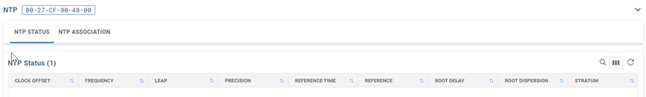

NTP
AP Statistics – NTP Status Information Display shows an example of Network Time Protocol (NTP) information displayed for APs in the RF Domain. This information is presented in tabular form.
AP Statistics - NTP Information Description describes the type of information displayed under each column in the table.
Table 9. AP Statistics - NTP Information Description
Column HeadingDescription
Clock OffsetDisplays the time differential between the AP's time and its NTP resource‘s time.
FrequencyIndicates the SNTP server clock‘s skew (difference) for the AP.
LeapIndicates if a second is added or subtracted to SNTP packet transmissions, or if transmissions are synchronized.
PrecisionDisplays the precision of the time clock (in Hz). The values that normally appear in this field range from -6 (for mains-frequency clocks) to -20 (for microsecond clocks).
Reference TimeDisplays a time stamp indicating when the AP‘s clock was last synchronized or corrected.
ReferenceDisplays the address of the time source with which the AP is synchronized.
Root DelayDisplays the total round-trip delay in seconds. This variable can take on both positive and negative values, depending on relative time and frequency offsets. The values that normally appear in this field range from negative values (a few milliseconds) to positive values (several hundred milliseconds).
Root DispersionDisplays the difference between the time on the root NTP server and its reference clock. The reference clock is the clock used by the NTP server to set its own clock.
StratumDisplays how many hops the AP is from its current NTP time resource.

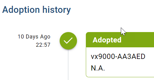

Adoption History
AP Statistics – Example Adoption History Display shows an example of Adoption History information displayed for APs in the RF Domain.
If adoption is unsuccessful, "N.A." is replaced with a reason message (for example, auto-provisioning policy issue, licensing issue, or device is unreachable).

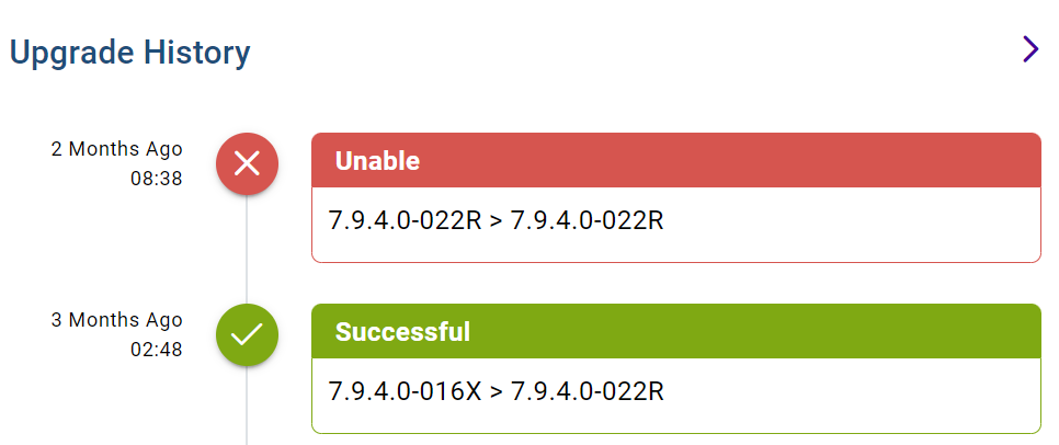

Upgrade History
AP Statistics – Example Upgrade History Display shows an example of Upgrade History information displayed for APs in the RF Domain.

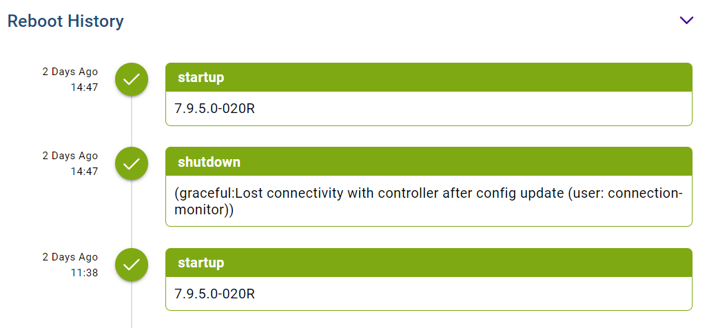

Reboot History
Check the Reboot History statistics to assess performance of the selected AP. If the AP reboots frequently, you can go to Diagnostics > Event History and consult the data recorded for the selected AP to help determine the cause.
Access Point Statistics - Example Reboot History Display shows an example of Reboot information displayed for APs in the RF Domain.
