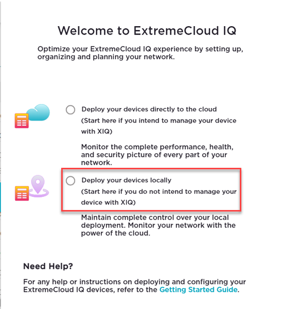

To onboard ExtremeCloud IQ Controller to ExtremeCloud IQ using the Welcome dialog, take the following steps:
  1. Log into your ExtremeCloud IQ account and select
    The ExtremeCloud IQ Navigator or Pilot account is supported.
    The Welcome dialog displays.
    ExtremeCloud IQ Welcome Dialog
  2. For ExtremeCloud IQ Controller, select Deploy your devices directly to the cloud.
  3. On the next screen, select Let‘s Get Started.

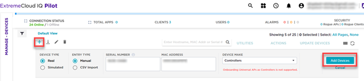

Add a Controller — Quick Add
To onboard ExtremeCloud IQ Controller to ExtremeCloud IQ using the Quick Add function, take the following steps:
  1. From the ExtremeCloud IQ main navigation pane, select Manage Devices.
  2. Select Quick Add ().
  3. In the Serial Number field, enter the ExtremeCloud IQ Controller serial number.
    This is the Locking ID of the controller. Find the controller Serial Number under the controller's License Details. From the controller, go to Administration > License > License Details.
    The Device Make field displays.
  4. From the Device Make field, select Controllers.
    Manually adding a controller to ExtremeCloud IQ
    The MAC Address field displays.
  5. In the MAC Address field, enter the ExtremeCloud IQ Controller MAC Address.
    Find the controller MAC Address under the controller's License Details. From the controller, go to Administration > License > License Details.
  6. Select Add Devices.
    Controller Add Device Fields
The controller is added the list of managed devices.
Controllers in Managed Devices List - ExtremeCloud IQ
