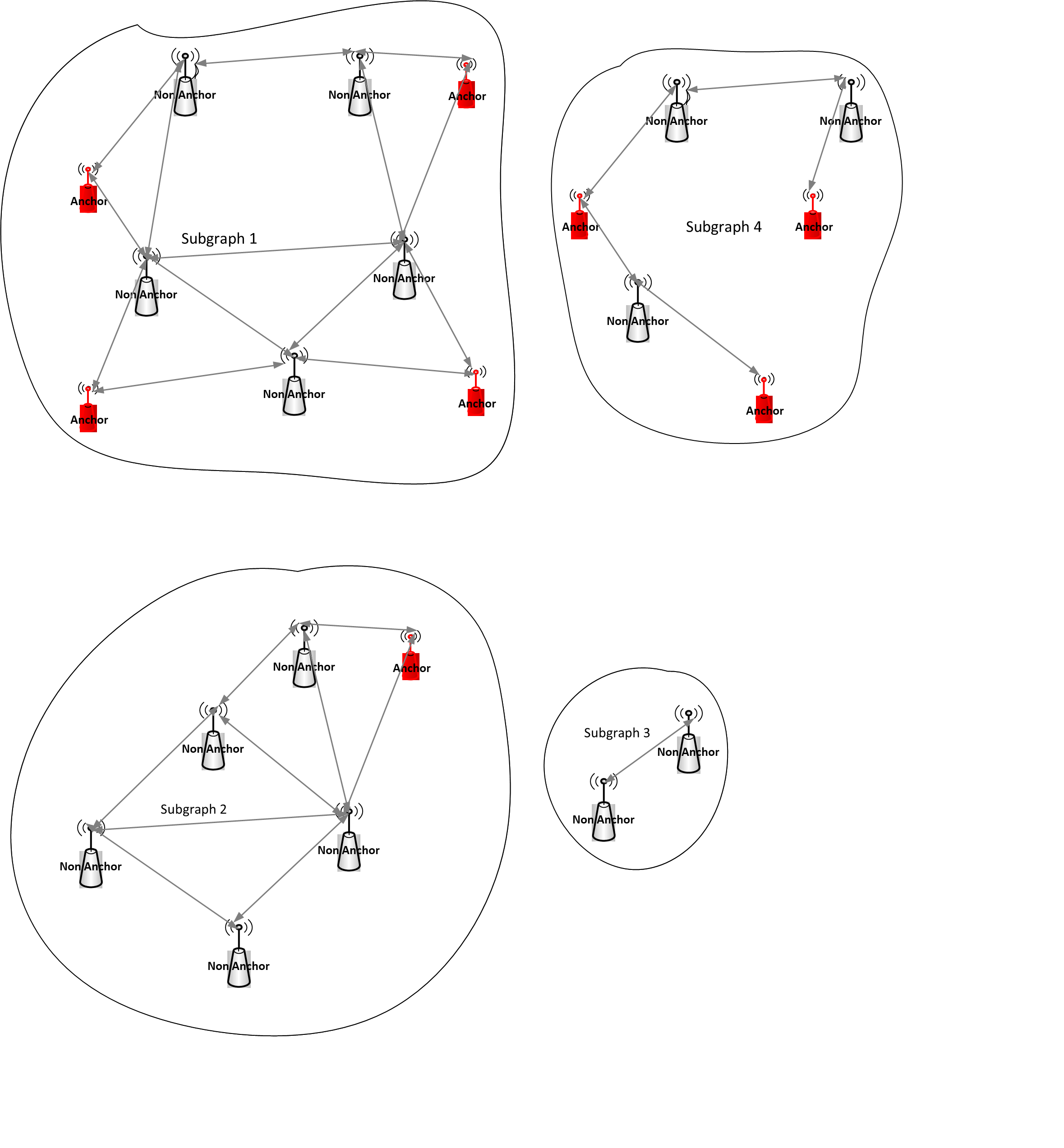

The APs belonging to subgraphs might have geo-location coordinates assigned. See the following scenarios and recommendations for corrective actions.
Example Subgraph Scenarios
Subgraph 1
The group of APs belonging to Subgraph 1 satisfy the AP graph connectivity and the number of anchor AP requirements. As a result, the geolocation agent derived coordinates for each of them.
No corrective action required.
Subgraph 2
The group of APs belonging to Subgraph 2 satisfy the AP graph connectivity rules, but not the number of anchor AP requirements. As a result, the geolocation agent did not derive coordinates for these APs.
Corrective action: Install more APs between Subgraph 1 and Subgraph 2 to add more connections between the subgraphs and merge them.
Subgraph 3
When the AP graph connectivity rule is not met, but the number of anchor APs requirement is met, geolocation coordinates are not derived.
Corrective action: Reposition the APs, or install more APs, to achieve connectivity with the rest of the APs on the floor.
Subgraph 4
When neither requirement is met, geo-location coordinates are not derived. Take the following corrective actions:
Corrective action: Reposition the APs or install more APs to achieve connectivity with the rest of the APs on the floor.
