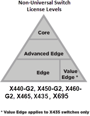

The limits data is grouped by license level that contains the associated features:
Non-universal switches include the following license levels:
Switch Category Switches Applicable License Levels
Non-universal switches X435 *, X440-G2, X450-G2, X460-G2, X465, X695 Value Edge *, Edge, Advanced Edge, Core
Note: * The X435 is the only switch that supports the Value Edge license level.
Note: X590, X620-X (fiber), and X690 are not supported in this version.
The following figure illustrates that each license level builds on the features of the license level below it. For example, the Advanced Edge license includes all of the features in the Edge license, plus the features in the Advance Edge license level.
License Levels for non-Universal Switches
license levels
