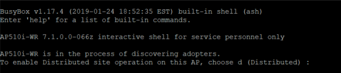

You
                            will be prompted: '
To enable distributed site operation on this
                                AP, choose d (Distributed):'

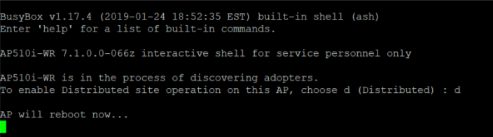

                        Type
                            'd'.
The
                            following message is displayed:
The AP will reboot in the
                                standalone/distributed operational
                            mode.

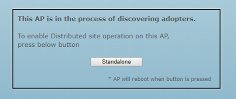

                        Alternately, access the AP's GUI by pointing the
                            Web browser to the AP's Primary or Secondary IP
                            address. (http://<AP-IP-ADDRESS>)
Primary IP address - This is the DHCP provided IP
                            address.
                        Secondary IP address - This is the ZEROCONF IP
                            address printed on the box.
                        The
                        Click on the “Standalone” button.

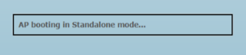

The
                            mode.

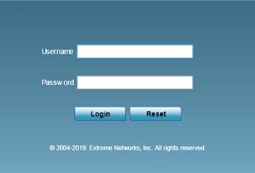

                Access the first upgraded AP's GUI, by pointing the Web browser to the AP's
                    Primary (DHCP-provided) or Secondary (ZEROCONF) IP address.
The
                    login page is displayed.
                Enter credentials admin/admin123.

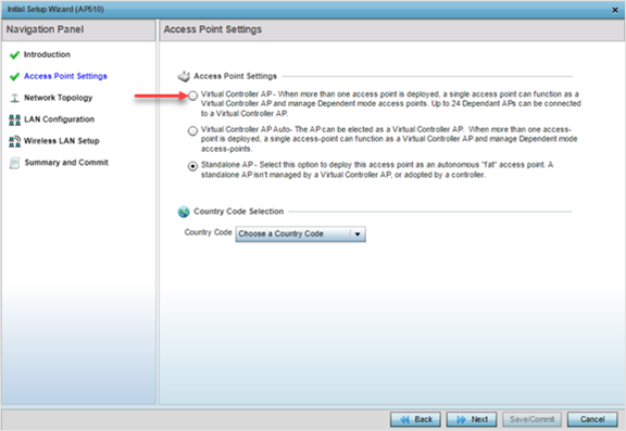

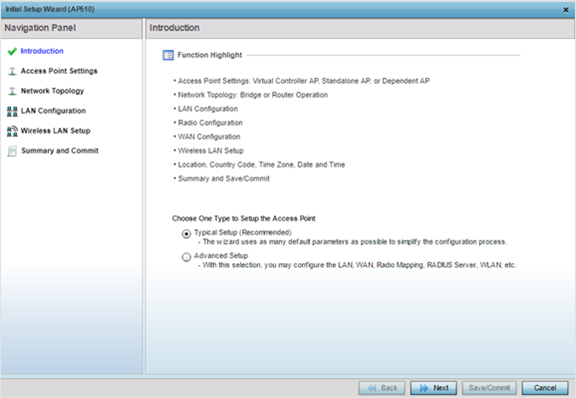

                Use the Initial Setup Wizard to configure the AP as a
                    Virtual Controller.
                Click
                        Next.
                On the
                        Access Point Settings screen,
                    select the Virtual
                        Controller AP radio button.
The
                    AP is now configured as a VC. At this point, the other 'Rev:
                    AA' APs in the VLAN will adopt to the virtual controller
                    AP.
