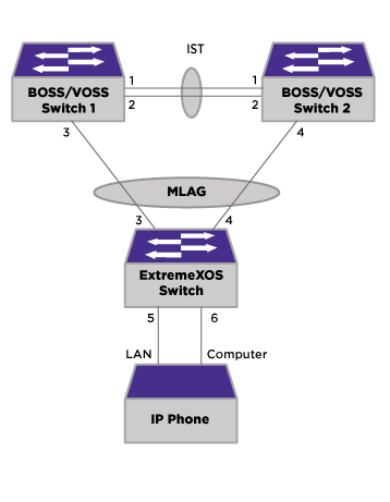

The most common use case is with an IP phone with two ports: one for a switch and one for a computer (see SLPP Use Case). If you plug both IP phone ports onto the edge switch, a loop is created. To avoid a loop in the SMLT network, on the ExtremeXOS edge switch, enable SLPP Guard on the ports that are connected to the IP phone.
SLPP Use Case
