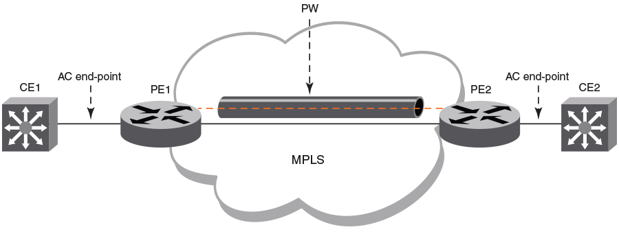

The following figure depicts an enterprise VLL service.
CE1 and CE2 are the customer edge devices in geographically separate sites.
Pseudowire (PW) is a circuit emulation infrastructure that extends L2 connectivity from CE1 to CE2 by way of PE1 and PE2. The tunnel is typically a L3 tunnel on which a L2 circuit is emulated.
