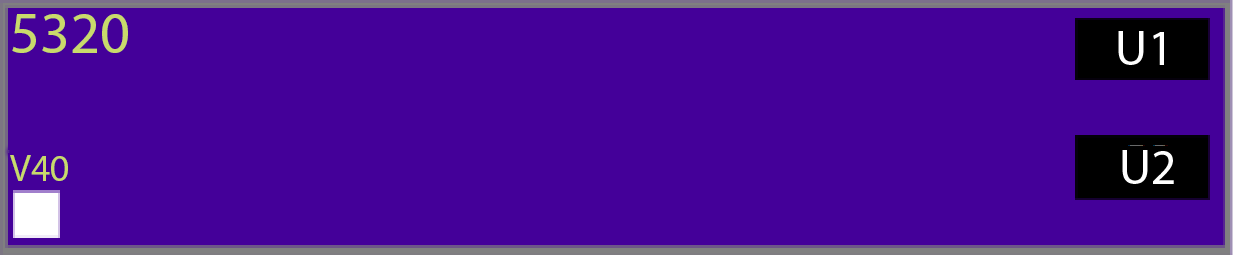

    Each switch model is represented by a rectangle, as shown in the example in the following figure.ach switch model is represented by a rectangle, as shown in the example in the following figure. In this example, stacking ports are represented by U1 and U2 on the right side.
    5320 Switch Shown in the Stacking Tool
