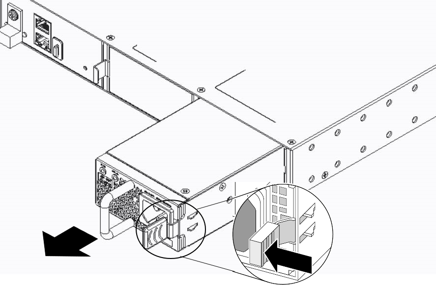

Use the following instructions to remove a power supply.
Attach an ESD-preventive wrist strap to your bare wrist and connect the metal end to an appropriate ground point on the rack.
Caution
Power supplies can become very hot during operation. Wear thermal protective gloves when you remove a power supply from an operating switch.
Note the orientation and the airflow direction of the installed power supply, and the location of the latching tab on the power supply.
Push the latching tab toward the power supply handle and pull outward on the handle to disengage the power supply internal connectors.
Remove a Power Supply
If you are not installing a replacement power supply, install a cover over the unoccupied power supply bay. Unoccupied bays must always be covered to maintain proper system ventilation and EMI levels.

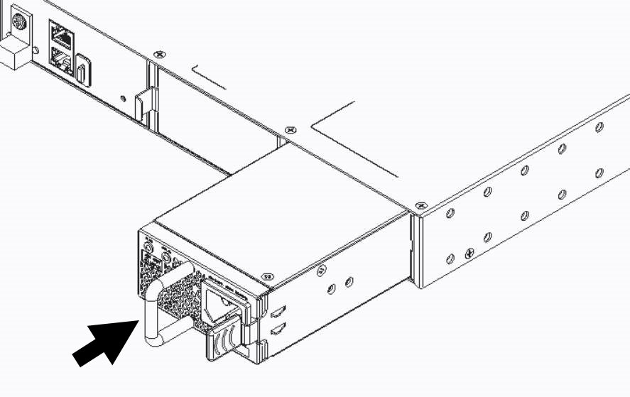

Replace or Install a Power Supply
Use the following instructions to replace or install a power supply.
If necessary, remove a blank panel from the back of the switch.
Ensure that the orientation of the power supply is correct, and that the new power supply's airflow direction (front-to-back or back-to-front) is compatible with the installed fan modules and any other installed power supplies.
Carefully slide the power supply all the way into the power supply slot.
Push the power supply in until the latch snaps into place.
Do not slam the power supply into the switch.
Be sure to install a cover over any unoccupied power supply slots. Unoccupied power supply slots must always be covered to maintain proper system ventilation and EMI levels.
To install or replace a second power supply repeat this procedure.
After installing a power supply, connect the power cord to the power supply.

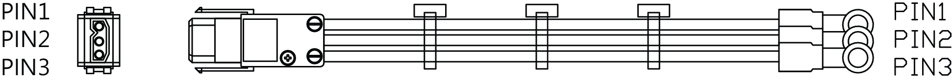

DC Power Cable
Use the following for building the wire harness:
Cable Connector
Wire Color
Pin 1
Yellow/Green
GRD
Pin 2
Black
-48V
Pin 3
Red
RTN
Connect the ring terminal of the red RTN power cable to the positive terminal of the DC power source, and connect the ring terminal of the black -48V power cable to the negative terminal of the DC power source.
