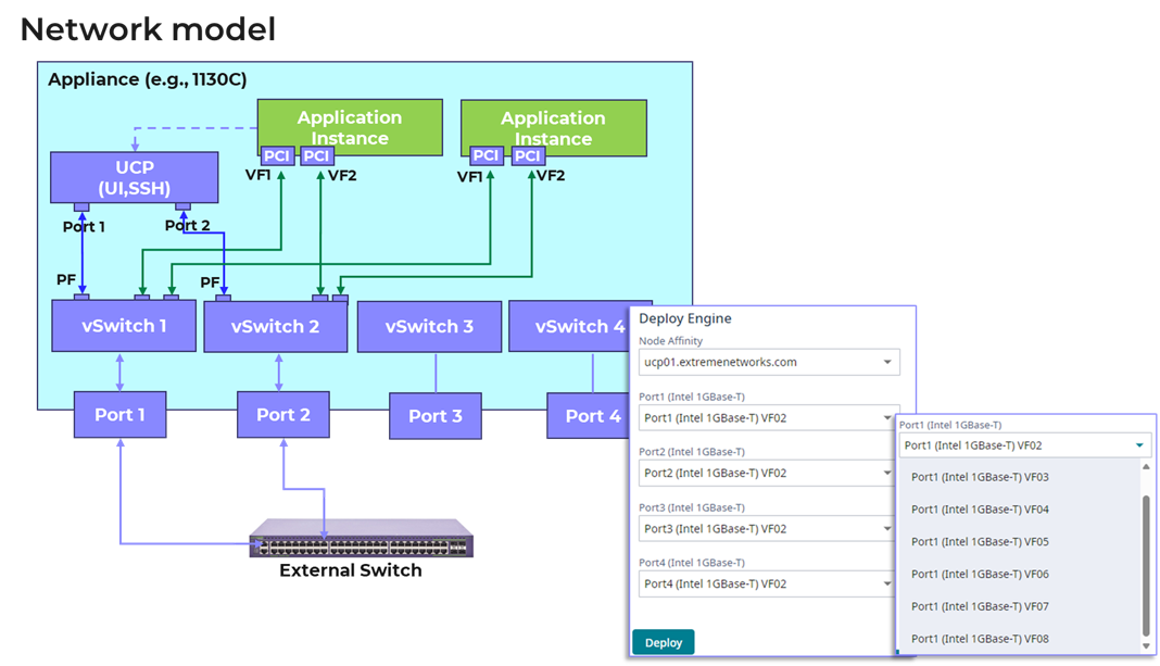

Example
The following image illustrates the network connections on an 1130C that has two application instances that use VF01 and VF02 respectively. The Universal Compute Platform OS attaches to the physical function (PF) of vSwitch 1 and vSwitch 2. The user interface callouts display how, for each data port, you can allocate one of eight VFs to that application instance.
