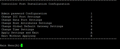

    Controller Post Installation Configuration Menu Screen
    Table 1. Controller Post Installation Configuration Menu
    Menu Option Command
    Admin password Configuration 1
    Change ICC Port Settings 2
    Change Data Port Settings 3
    Change Host Attribute Settings 4
    Change Global Default Gateway Settings 5
    Change Time Settings 6
    Apply Settings and Exit A
    Exit Without Applying E
    An Inter-Cluster Connection (ICC) is not required in a Standalone deployment.
    When you revisit any other screen, you will have to reconfigure all subsequent area settings. For example, if you decide to reconfigure the Admin Password, which is at the beginning of the configuration wizard, you will have to reconfigure all the subsequent configuration wizard settings.
  7. Press Enter to accept the settings. The default option for accepting the settings is A. Your settings are now applied successfully.
