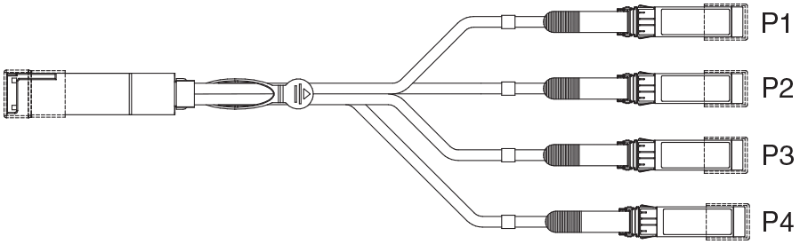

First and last ports of the SLX 9150 uplinks are capable of breakouts (they are color coded differently too).
QSFP+ to 4 SFP+ (4 x 10 GbE) direct-attach copper breakout cable
