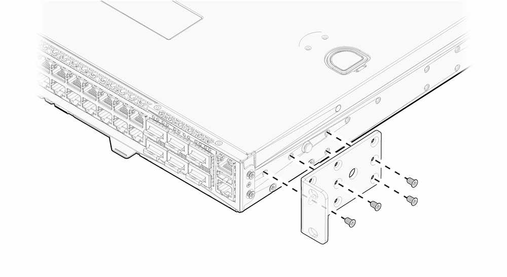

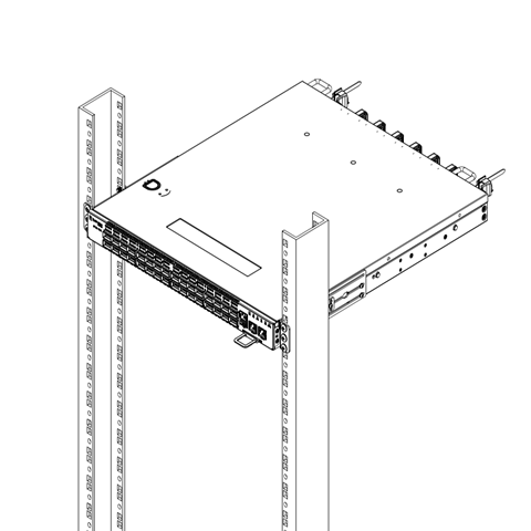

For a front mount,
position the bracket over the holes so that the flange (ear) is even
with the front of the switch, as shown in the figure below: Attaching
a Short Mounting Bracket (Ear): Front of Switch .
Attaching a

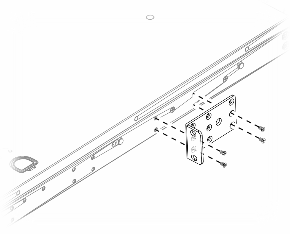

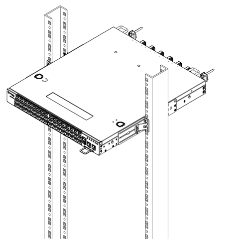

For a mid-mount,
position the bracket so that the flange (ear) is positioned slightly
more than halfway between the front and back of the switch, as shown in
figure below: Attaching a Short Mounting Bracket (Ear): Middle of
Switch .
Attaching a
Short Mounting Bracket (Ear): Middle of Switch
Use four small mounting screws (provided) to attach the bracket to the
switch.

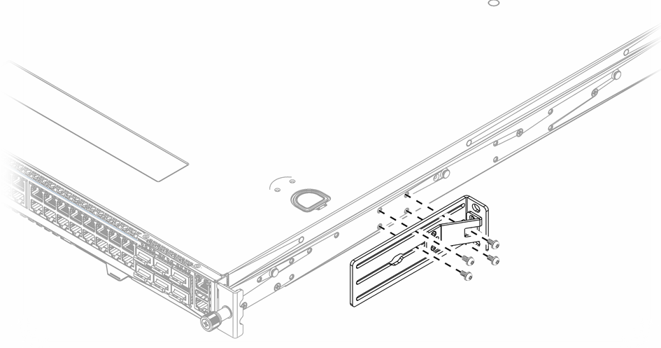

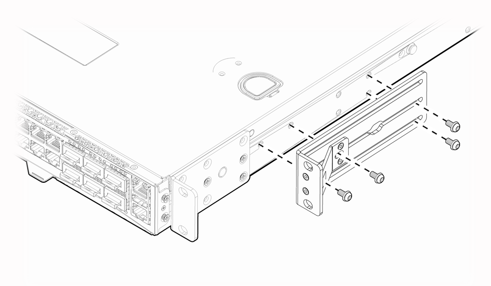

Attach a long mounting bracket to one side of the switch housing and to the
rack post.
Position the long
bracket over the holes between the front and the middle of the switch.
Orient it so that its flange (ear) rests against the rack post.
See the diagrams below: Attaching a Long Mounting Bracket: Front
of Switch and Attaching a Long Mounting Bracket: Middle
of Switch.
Attaching a Long Mounting Bracket: Front of Switch
Attaching a Long Mounting Bracket: Middle of Switch
switch.
Secure the long bracket to the rack post.
(Rack-mounting screws are not provided.)
Repeat step 3 to attach the
other long bracket on the other side of the switch.

The completed installation is shown in the diagrams below: Two-Post Front
Mount: Complete and Two-Post Mid-Mount: Complete.
Two-Post Front Mount:
Complete
Two-Post Mid-Mount:
Complete
