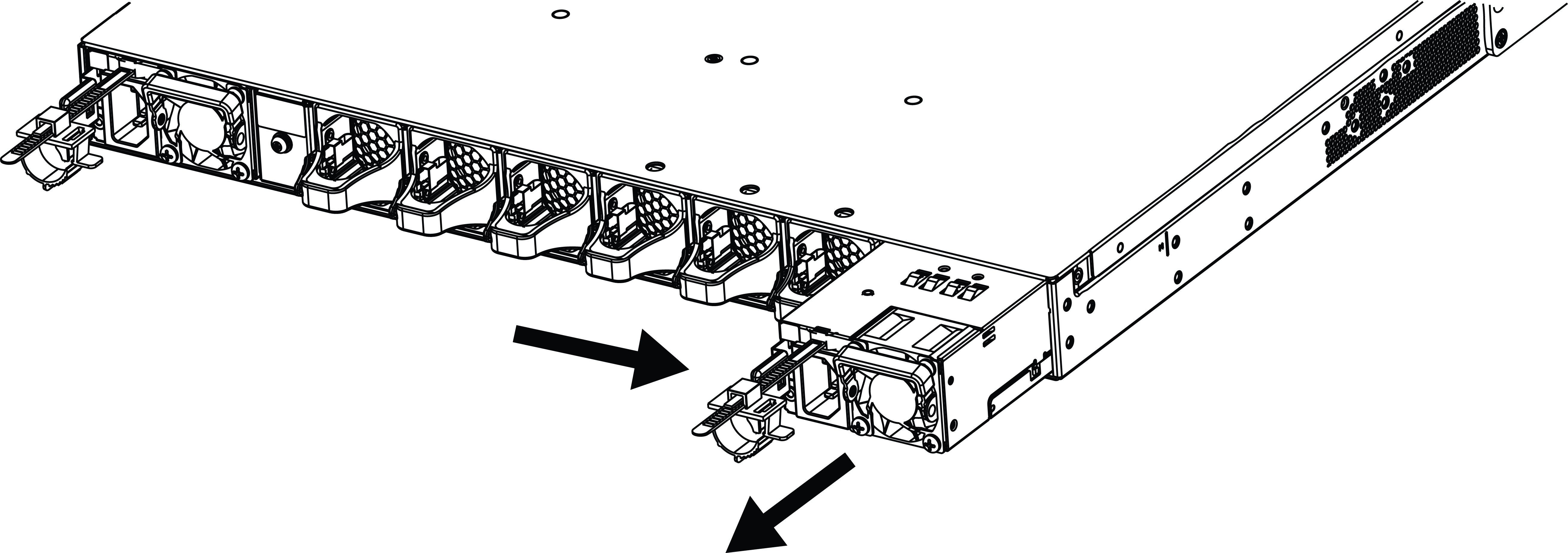

    Power supplies can become very hot during operation. Wear thermal protective gloves when you remove a power supply from an operating switch.
  2. Note the orientation and the airflow direction of the installed power supply, and the location of the latching tab on the power supply.
  3. Push the latching tab toward the power supply handle and pull outward on the handle to disengage the power supply internal connectors.
    Remove a Power Supply
  4. Carefully slide the power supply the rest of the way out of the switch.

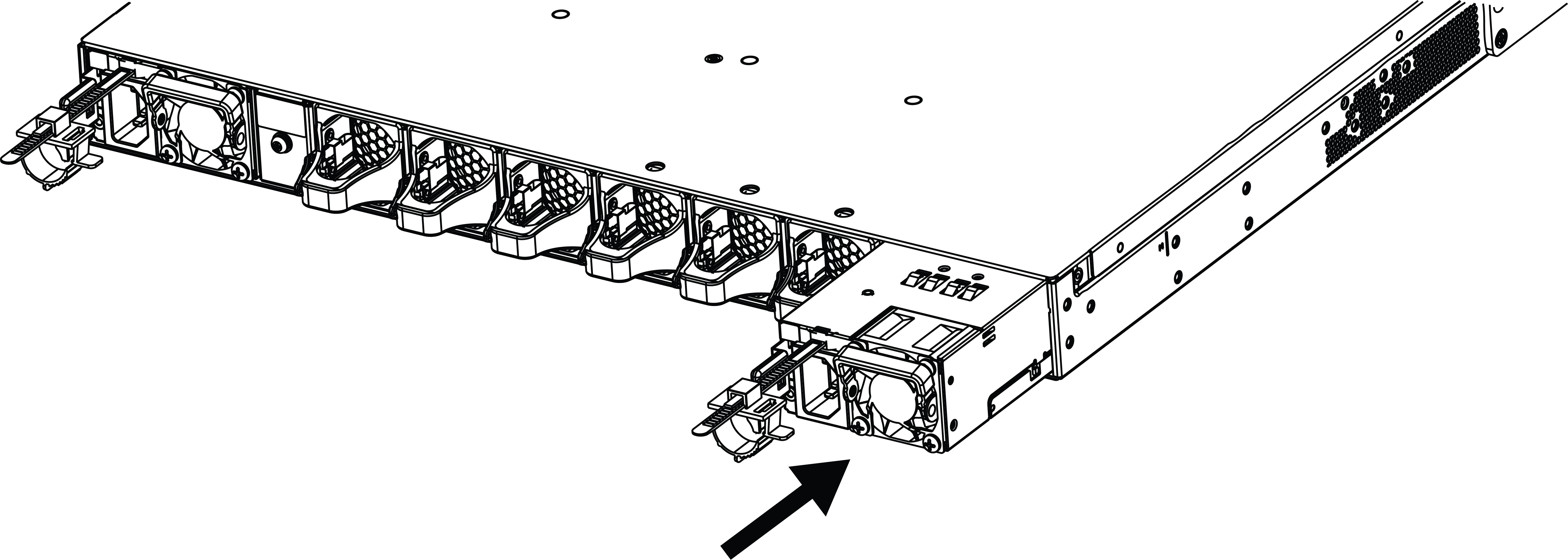

  3. Ensure that the orientation of the power supply is correct, and that the new power supply's airflow direction (front-to-back or back-to-front) is compatible with the installed fan modules and any other installed power supplies.
  4. Carefully slide the power supply all the way into the power supply slot.
    Install a Power Supply
  5. Push the power supply in until the latch snaps into place.
    Do not slam the power supply into the switch.
