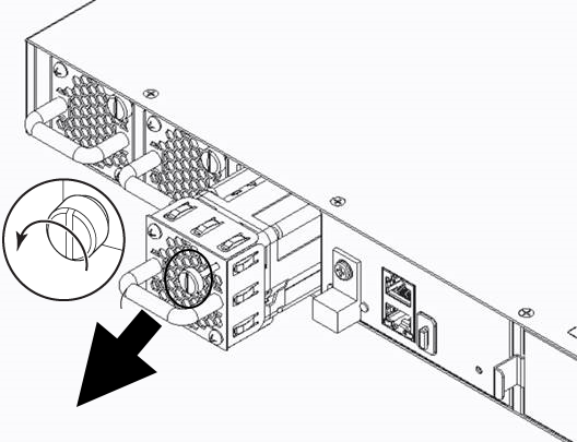

You need a 1/4-inch flat-blade screwdriver to replace a fan module.
Caution
Be sure to finish the replacement procedure promptly. The switch could overheat if left without cooling for an extended period.Use the following instructions to remove a fan module.
On most switch models, the fan module has two retaining screws at the bottom corners of the module, as shown in Removing a Fan Module.
On some switch models, the fan module has a single retaining screw at the top right corner of the module.

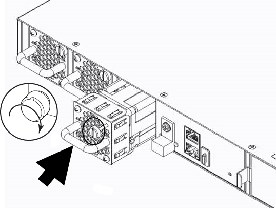

Use the following instructions to install a fan module.
Fan modules labeled Air Out provide front-to-back airflow.
Fan modules labeled Air In provide back-to-front airflow.
