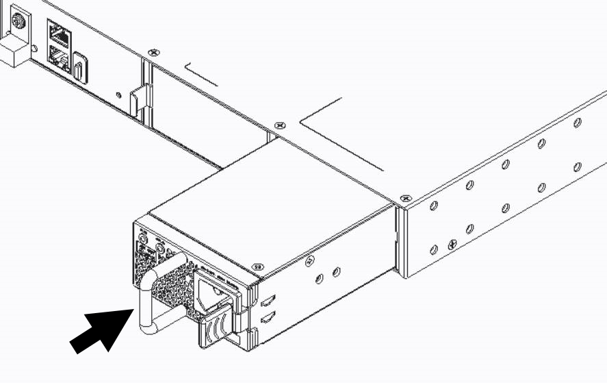

Remove a Power Supply
Caution
Disconnect the AC power cord from the wall outlet and from the power supply before removing an AC power supply.
Use the following instructions to remove a power supply.
Attach an ESD-preventive wrist strap to your bare wrist and connect the metal end to an appropriate ground point on the rack.
Caution
Power supplies can become very hot during operation. Wear thermal protective gloves when you remove a power supply from an operating switch.

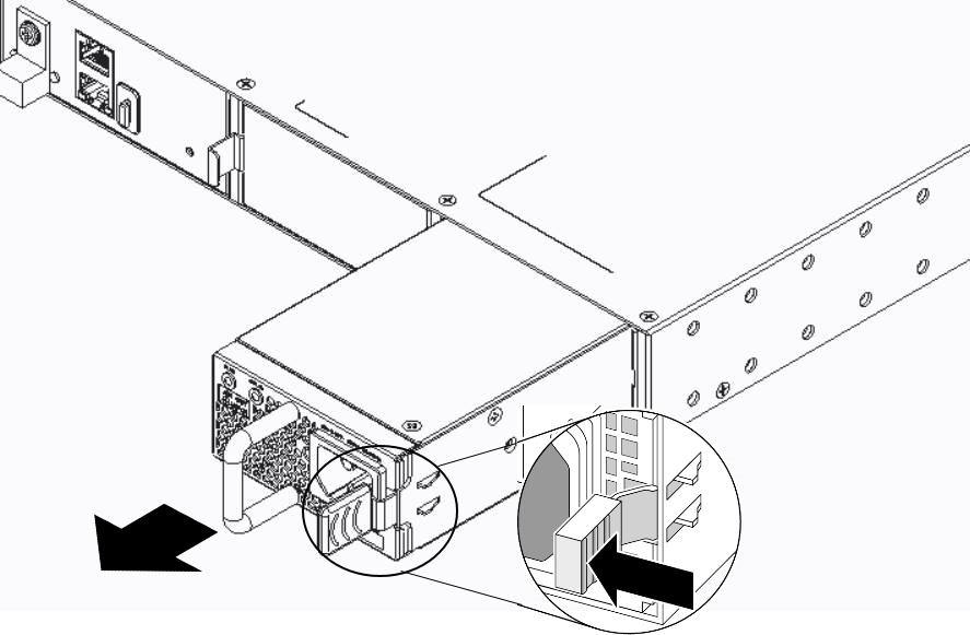

Note the orientation and the airflow direction of the installed power supply, and the location of the latching tab on the power supply.
Push the latching tab toward the power supply handle and pull outward on the handle to disengage the power supply internal connectors.
Carefully slide the power supply the rest of the way out of the switch.
If you are not installing a replacement power supply, install a cover over the unoccupied power supply bay. Unoccupied bays must always be covered to maintain proper system ventilation and EMI levels.
