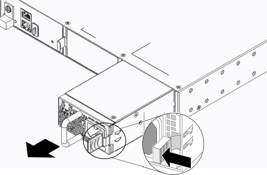

  2. Note the orientation and the airflow direction of the installed power supply, and the location of the latching tab on the power supply.
  3. Push the latching tab toward the power supply handle and pull outward on the handle to disengage the power supply internal connectors.
    Remove a Power Supply
  4. Carefully slide the power supply the rest of the way out of the switch.

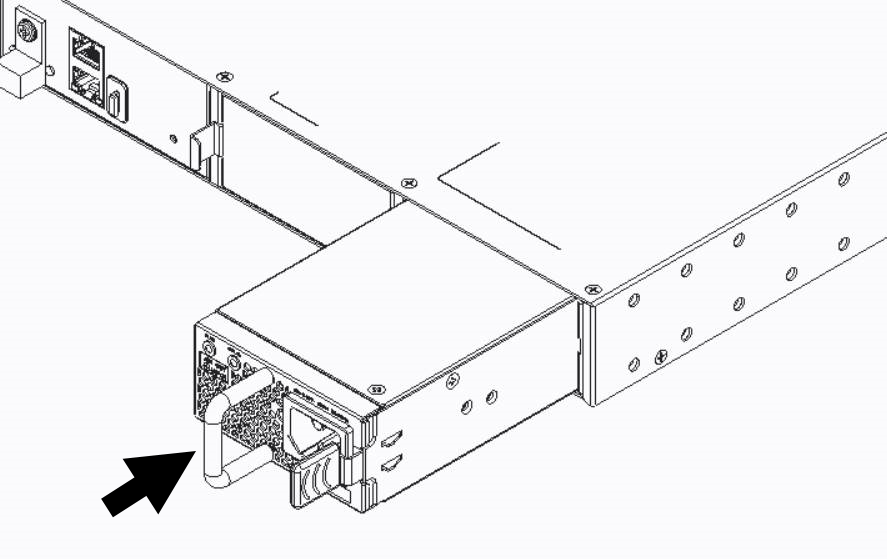

  3. Ensure that the orientation of the power supply is correct, and that the new power supply's airflow direction (front-to-back or back-to-front) is compatible with the installed fan modules and any other installed power supplies.
  4. Carefully slide the power supply all the way into the power supply slot.
    Install a Power Supply
  5. Push the power supply in until the latch snaps into place.

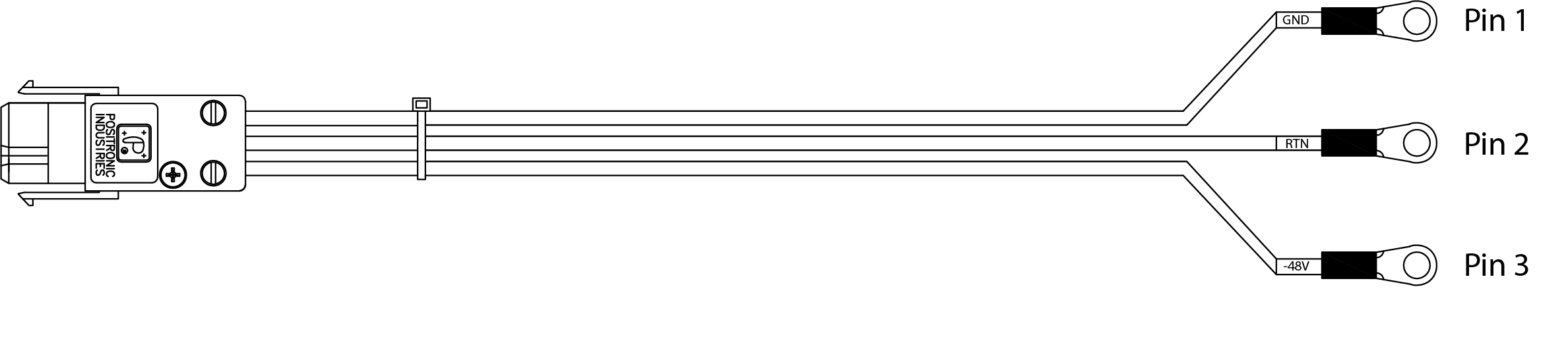

    1. Connect the ring terminal of the yellow and green ground wire to a known reliable earth ground point at your site.
      DC Power Cable
      DC Power Cable
      Use the following for building the wire harness:
      Cable ConnectorWire ColorRing Terminal
      Pin 1Black-48VPin 3
      Pin 2RedRTNPin 2
      Pin 3Yellow/GreenGRDPin 1
    2. Connect the ring terminal of the red RTN power cable to the positive terminal of the DC power source, and connect the ring terminal of the black -48V power cable to the negative terminal of the DC power source.
