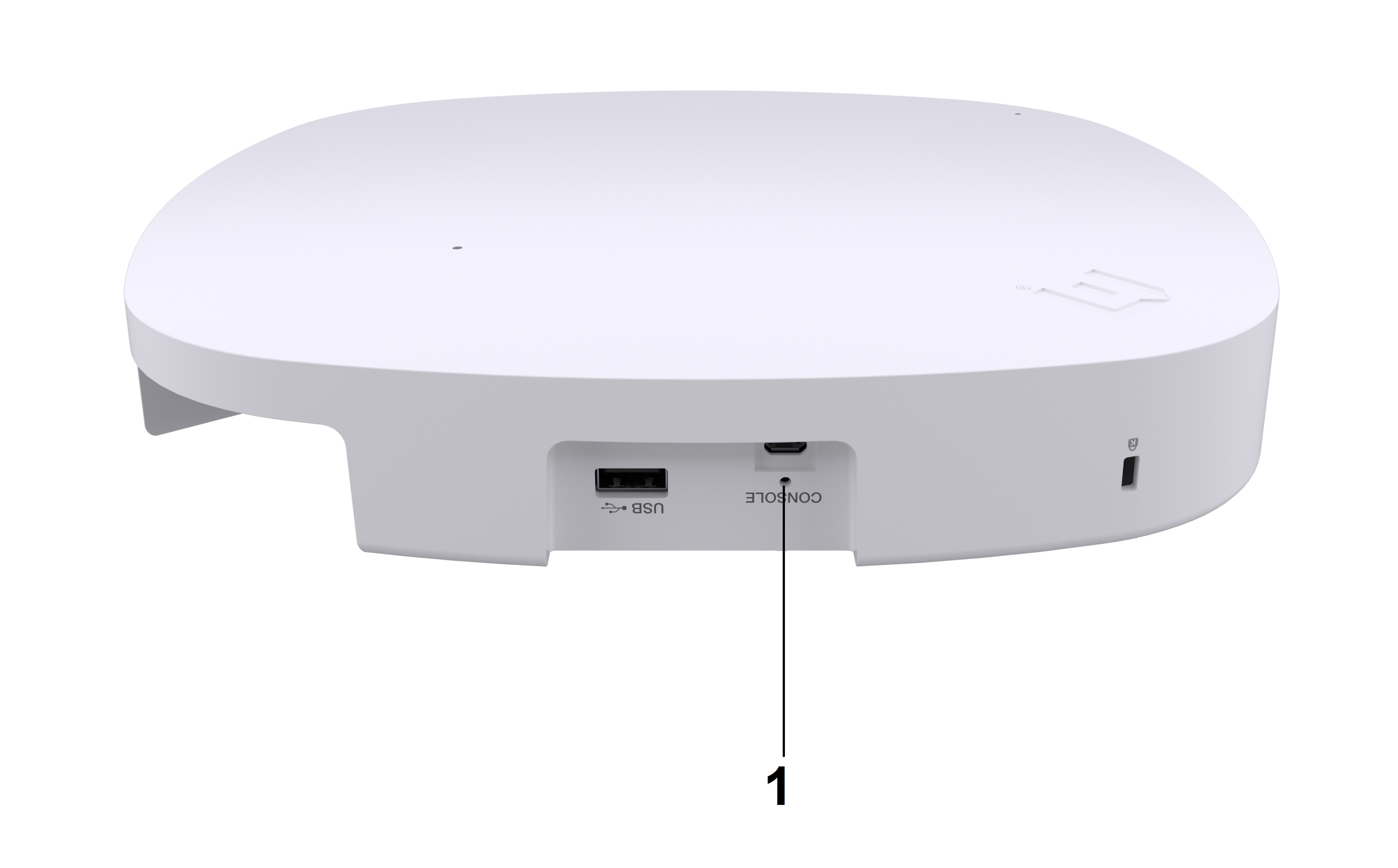

The Reset button is located next to the Console port.
Reset Port
reset port
Table 1. AP4020 Reset Port
ItemPortDescription
1ResetUsed to reboot the AP or do a factory reset.
