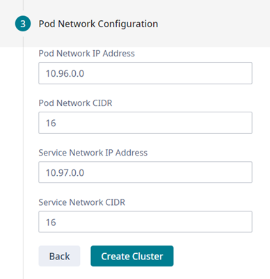

  3. Provide the settings for Pod Network Configuration:
    • Pod Network IP Address
    • Pod Network CIDR
    • Service Network IP Address
    • Service Network CIDR
    Pod Settings
    Pod Configuration Settings
  4. Select Create Cluster.
  5. Select Done.
