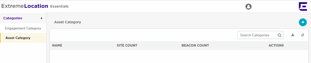

Use the icon to view the Category screen.
By default the Engagement Category screen displays. This screen displays a list of categories that you have defined for engaging with your visitors.
Select the Asset Category menu item from the list on the left of the screen. The Categories screen displays a list of all asset categories defined for your ExtremeLocation Essentials account.
The Categories screen displays the following information:
FieldDescription
NameDisplays the name of the category.
Site CountDisplays the number of sites that have used this category.
Beacon CountDisplays the number of BLE beacons to which this category is assigned.
ActionsLists the actions that can be performed on this category entry. Select the icon to view this category's details in a separate screen.
Periodically use the button to refresh this screen manually.
Use the icon to download the categories listed in this screen in a .csv file.
