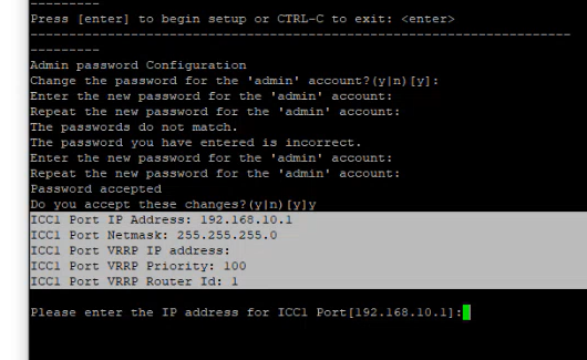

After logging into the appliance, the Basic Configuration Wizard displays. You are presented a set of Yes or No commands.
  1. To begin the Admin password setup, press Enter. The Admin Password Configuration screen is displayed.
    The following is the default factory settings for a Universal Compute Platform appliance:
    • The default username is: admin
    • The default password is: abc123
    The values are case-sensitive.
    1. To change the password for the admin account, press Enter.
    2. Enter the new password for the admin account.
      The password must be between 8-24 characters.
    3. Repeat the new password for the admin account and press Enter.
      If the passwords match, the password gets accepted, and the ICC1 configuration is displayed.
      Basic Configuration Wizard - ICC1 Configuration
  2. To update the ICC1 (Admin Port):
    • Enter the new IP address of the ICC1 Admin Port.
    • Enter the new IP netmask for the ICC1 port.
    • Do you you want to configure VRRP? Type y or n and press Enter. If you chose y, enter the ICC1 VRRP details.
    • Do you want to enable LAG on ICC1? Type y or n and press Enter.
  3. Press Enter to accept the changes.
    If you need to reconfigure the ICC1 settings, enter n and enter a new IP address of the ICC 1 Admin Port.

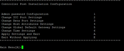

    Controller Post Installation Configuration Menu Screen
    Table 1. Controller Post Installation Configuration Menu
    Menu Option Command
    Admin password Configuration 1
    Change ICC Port Settings 2
    Change Data Port Settings 3
    Change Host Attribute Settings 4
    Change Global Default Gateway Settings 5
    Change Time Settings 6
    Apply Settings and Exit A
    Exit Without Applying E
    When you revisit any other screen, you will have to reconfigure all subsequent area settings. For example, if you decide to reconfigure the Admin Password, which is at the beginning of the configuration wizard, you will have to reconfigure all the subsequent configuration wizard settings.
  7. Press Enter to accept the settings. The default option for accepting the settings is A. Your settings are now applied successfully.
