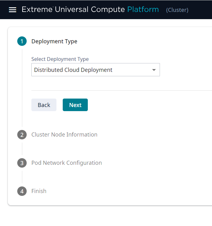

Configure Cluster
Settings
Select Distributed Cloud
Deployment in the Deployment Type
drop-down list.
Deployment Type
Selection

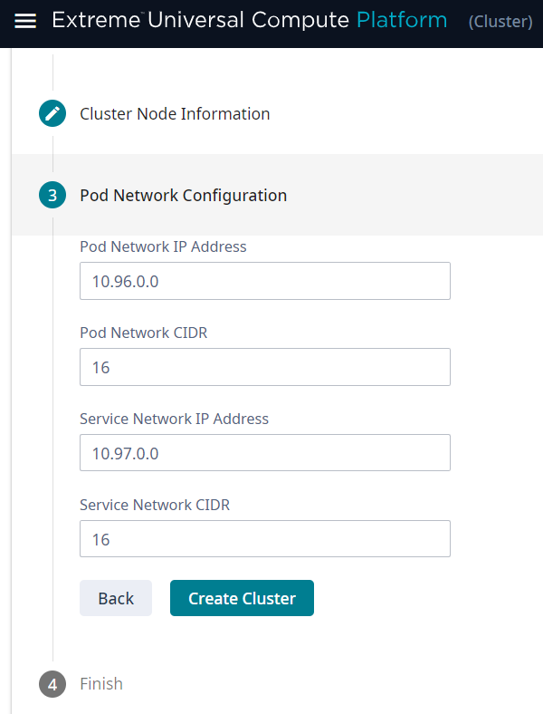

Provide the settings for
Pod Network
Configuration:
