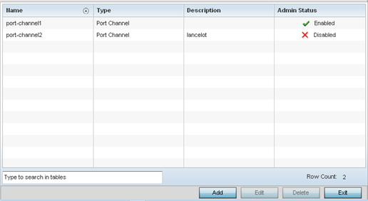

Expand the Interface menu and select Port Channels.
Refer to the following to review existing port channel configurations and their current status:
Name |
Displays the port channel's numerical identifier assigned to it when it was created. The numerical name cannot be modified as part of the edit process. |
Type |
Displays whether the type is port channel. |
Description |
Lists a short description (64 characters maximum) describing the port channel or differentiating it from others with similar configurations. |
Admin Status |
A green checkmark defines the listed port channel as active and currently enabled with the profile. A red "X" defines the port channel as currently disabled and not available for use. The interface status can be modified with the port channel configuration as required. |
