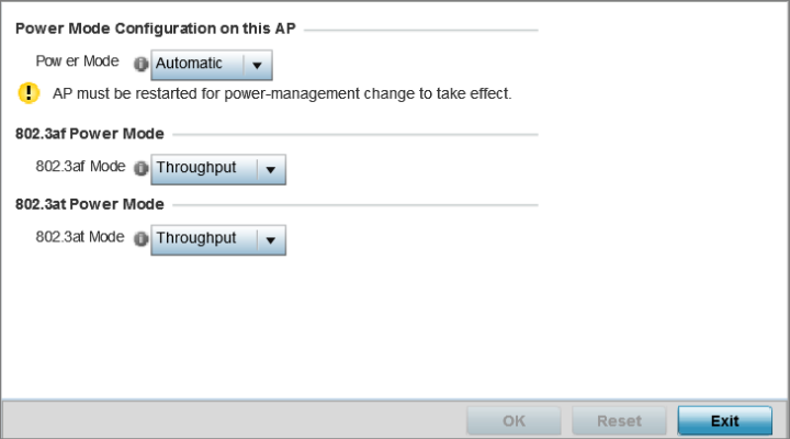

To define an access point‘s power configuration:
  2. Select an access point.
  3. Expand Profile Overrides and select Power.
    Device Configuration - System Profile - Power Screen
  4. Use the Power Mode drop-down menu to set the Power Mode Configuration on this AP.
    When an access point is powered on for the first time, it determines the power budget available. Using the Automatic setting, the access point automatically determines the best power configuration based on the available power budget. Automatic is the default setting.
    If 802.3af is selected, the access point assumes 12.95 watts are available. If the mode is changed, the access point requires a reset to implement the change.
  5. Set the access point radio‘s 802.3af Power Mode and the radio‘s 802.3at Power Mode.
    Use the drop-down menu for each power mode to define a mode of either Range or Throughput.
    Select Throughput to transmit packets at the radio‘s highest defined basic rate (based on the radio‘s current basic rate settings). This option is optimal in environments where the transmission range is secondary to broadcast/multicast transmission performance.
    Select Range when range is preferred over performance for broadcast/multicast (group) traffic. The data rates used for range are the lowest defined basic rates. Throughput is the default setting for both 802.3af and 802.3at.
  6. Select OK to save the changes made to the access point power configuration. Select Reset to revert to the last saved configuration.
