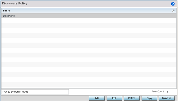

To display Bonjour discovery policy
information:
Select Configuration.
Select Services.
Select Bonjour Gateway to expand its
submenu.
Select Discovery Policy.
The
Discovery Policy screen
displays the name of the configured Bonjour discovery policies.
Bonjour Gateway - Discovery Policy
Screen
Select an existing policy and select Edit to modify its
configuration or select Add to create a new configuration..
Select an existing policy and click
Delete to
delete the policy, or use Copy to create a copy of a policy for further
modifications.

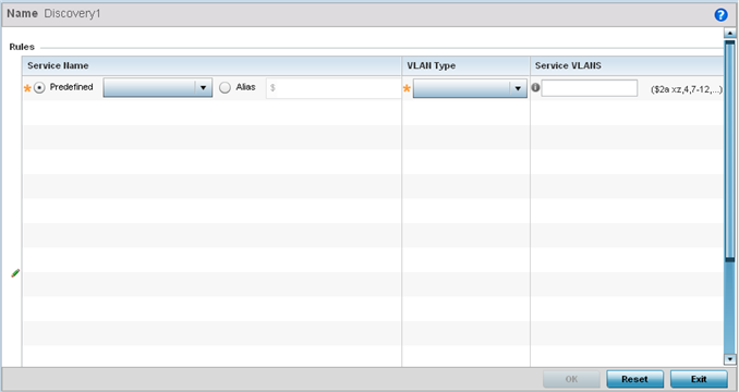

Bonjour - Discovery Policy - Add/Edit Policy
Screen
Select the + Add Row button to add a
rule to the Bonjour discovery policy.
These are the services discoverable by
the Bonjour gateway.
Set the following discovery attributes for the
discovery policy configuration:
Service Name |
Define the service that can be
discovered by the Bonjour gateway.
- Predefined – Use the drop-down
menu to select from a list of predefined Apple
services (Scanner, Printer, HomeSharing etc.).
- Alias – Use an existing alias to
define a service that is not available in the
predefined list.
VLAN Type |
Use the drop-down menu to select
the VLAN type.
- local – The VLAN(s) defined in the
Service VLAN field use a local
bridging mode.
- tunneled – The VLAN(s) defined in the
Service VLAN field are shared tunnel
VLANs.
Service VLANs |
Provide a VLAN or a list of VLANs
on which the selected service is discoverable. |
Click OK to save updates to this
Bonjour Discovery policy.
Click Reset to revert the screen to
its last saved configuration.
