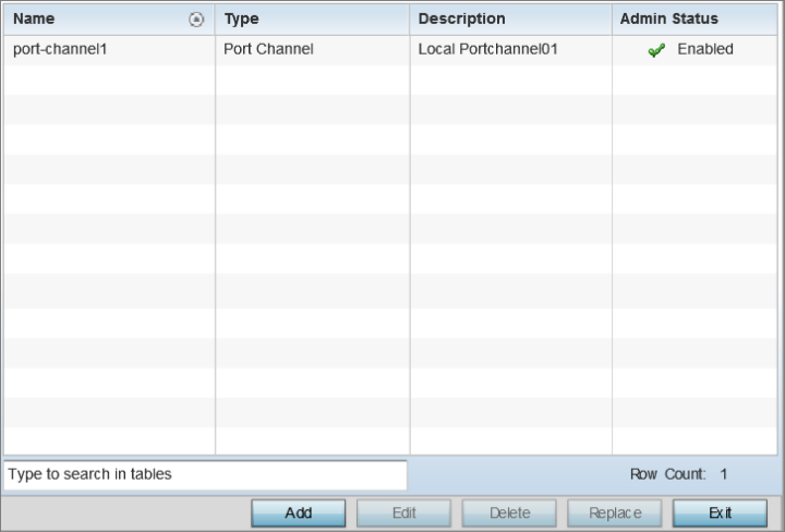

To review an access point's existing VLAN configurations
  2. Select an access point.
  3. Expand Interface and select Port Channels.
    The existing port channel configurations are displayed.
    Profile Overrides - Interface - Port Channels - Main Screen
  4. Review existing port channel configurations and their status to determine whether a parameter requires an override.
    Name
    The port channel's numerical identifier assigned when it was created. The numerical name cannot be modified as part of the edit process.
    Type
    Whether the type is port channel.
    Description
    A short description (64 characters maximum) describing the port channel or differentiating it from others with similar configurations.
    Admin Status
    A green check mark means the listed port channel is active and currently enabled with the profile. A red “X” means the port channel is currently disabled and not available for use. The interface status can be modified with the port channel configuration as required.
