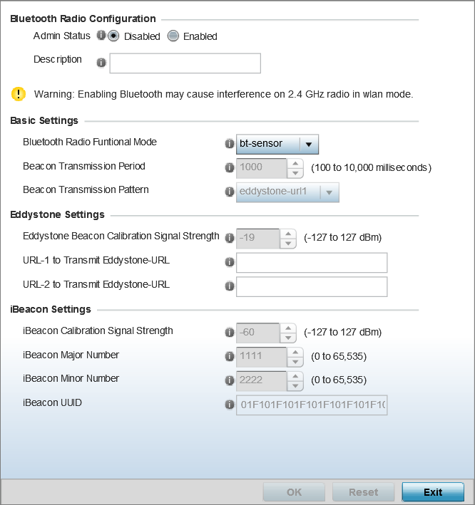

To override the access point's Bluetooth interface configuration:
The access point's bluetooth interface configuration is displayed.
Admin Status |
Select Enabled or Disabled to enable/disable Bluetooth support capabilities for AP-8432 or AP-8533 model access point radio transmissions. The default value is Disabled. |
Description |
Define a 64 character maximum description for the access point‘s Bluetooth radio to differentiate this radio interface from other Bluetooth supported radio‘s that might be members of the same RF Domain. |
Bluetooth Radio Functional Mode |
Use this drop-down menu to set the access point‘s
Bluetooth radio functional mode to one of the following
options:
Note:
If enabling the Bluetooth Radio Funtional Mode as le-beacon, configure the 'Beacon Transmission Period' and 'Beacon Transmission Pattern' values. |
Beacon Transmission Period |
Use this spinner control to set the Bluetooth radio‘s beacon transmission period from 50 - 10,000 milliseconds. As the defined period increases, so does the CPU processing time and the number packets incrementally transmitted (typically one per minute). The default setting is 1,000 milliseconds. Note:
This parameter is enabled when the functional mode is set to 'le-beacon'. |
Beacon Transmission Pattern |
Use this drop-down menu to set the beacon‘s transmission
pattern. The options are:
Note:
Eddystone Beacon Calibration Signal Strength |
Set the Eddystone Beacon measured calibration signal strength, from -127 dBm to 127 dBm, at 0 meters. Mobile devices can approximate their distance to beacons based on received signal strength. However, distance readings can fluctuate since they depend on several external factors. The closer you are to a beacon, the more accurate the reported distance. This setting is the projected calibration signal strength at 0 meters. The default setting is -19 dBm. |
URL-1 to Transmit Eddystone-URL |
Enter a 64-character maximum Eddystone-URL1. The URL must be 17 characters or less once auto-encoding is applied. URL encoding is used when placing text in a query string to avoid confusion with the URL itself. It is typically used when a browser sends data to a web server. |
URL-2 to Transmit Eddystone-URL |
Enter a 64-character maximum Eddystone-URL2. The URL must be 17 characters or less once auto-encoding is applied. URL encoding is used when placing text in a query string to avoid confusion with the URL itself. It is typically used when a browser sends data to a web server. |
Set the iBeacon measured calibration signal strength, from -127 dBm to 127 dBm, at 1 meter. Mobile devices can approximate their distance to beacons based on received signal strength. However, distance readings can fluctuate since they depend on several external factors. The closer you are to a beacon, the more accurate the reported distance. This setting is the projected calibration signal strength at 1 meter. The default setting is -60 dBm. |
iBeacon Major Number |
Set the iBeacon major value from 0 - 65, 535. Major values identify and distinguish groups. For example, each beacon on a specific floor in a building could be assigned a unique major value. The default value is 1,111. |
iBeacon Minor Number |
Set the iBeacon minor value from 0 - 65, 535. Minor values identify and distinguish individual beacons. Minor values help identify individual beacons within a group of beacons assigned a major value. The default setting is 2,222. |
iBeacon UUID |
Define a 32 hex character maximum UUID (Universally Unique IDentifier). The UUID classification contains 32 hexadecimal digits, split into 5 groups, separated by dashes – for example, f2468da6-5fa8-2e84-1134- bc5b71e0893e. The UUID distinguishes iBeacons in the network from all other beacons in networks outside of your direct administration. |
