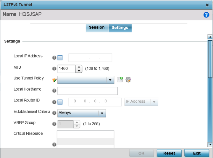

To define or override the L2TPv3 tunnel settings:
The L2TPv3 Tunnel Settings configuration screen displays.
Local IP Address |
Enter the IP address assigned as the local tunnel end point address, not the interface IP address. This IP is used as the tunnel source IP address. If this parameter is not specified, the source IP address is chosen automatically based on the tunnel peer IP address. This parameter is applicable when establishing the tunnel and responding to incoming tunnel create requests. |
MTU |
Set the MTU. The MTU is the size (in bytes) of the largest protocol data unit the layer can pass between tunnel peers. Define a MTU between 128 - 1,460 bytes. The default setting is 1,460. A larger MTU means processing fewer packets for the same amount of data. |
Use Tunnel Policy |
Select the L2TPv3 tunnel policy. The policy consists of user defined values for protocol specific parameters which can be used with different tunnels. If none is available a new policy can be created or an existing one can be modified. For more information, refer to L2TP V3 Configuration. |
Local Hostname |
Provide the tunnel specific hostname used by this tunnel. This is the hostname advertised in tunnel establishment messages. |
Local Router ID |
Specify the router ID sent in tunnel establishment messages with a potential peer device. |
Establishment Criteria |
Configure establishment criteria for creating a tunnel
between the device and the NOC. This criteria ensures
only one tunnel is created between two sites where the
tunnel is established between the vrrp-master/cluster
master/rfdomain manager at the remote site and the
controller at the NOC. The tunnel is created based on
the role of the remote peer.
In all the above cases, if the local device goes offline for any reason, the tunnel is brought down. |
VRRP Group |
This field is enabled only when the establishment criteria is set to vrrp-master. Use the spinner to select the VRRP group. |
Critical Resource |
Enter the critical resources required for creating and maintaining a L2TPV3 tunnel. A tunnel is only established when all critical resources for the tunnel to be operational are available at the time when the tunnel is created. If any one of the listed critical resources goes down, the tunnel is disabled. When a tunnel is established, the listed critical resources are checked for availability. Tunnel establishment is started if the critical resources are available. Similarly, for incoming tunnel termination requests, listed critical resources are checked and tunnel terminations are only allowed when the critical resources are available. For more information on managing critical resources, see GUID-62B1FF44-FC62-402E-9823-049E2E9221EF#GUID-62B1FF44-FC62-402E-9823-049E2E9221EF. |
