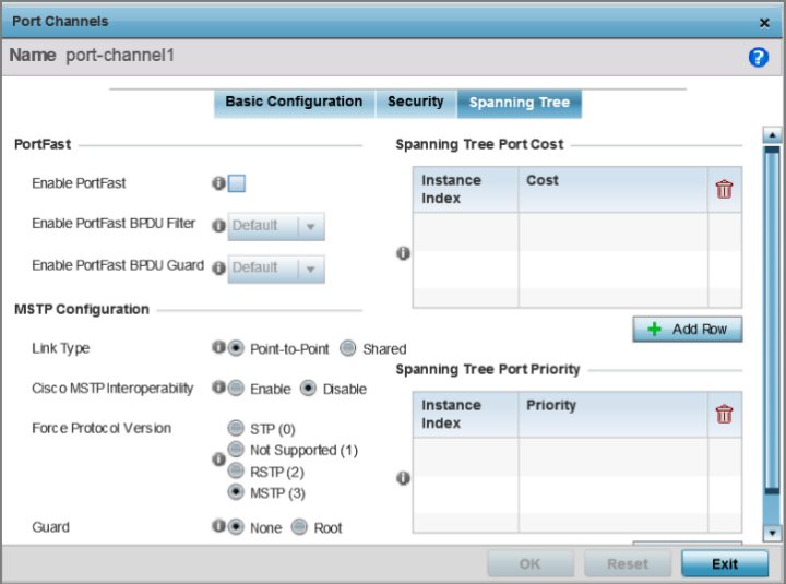

To configure the port channel's spanning tree configuration:
Enable PortFast |
Select this option to enable drop-down menus for the Enable PortFast BPDU Filter and Enable PortFast BPDU Guard options. This setting is disabled by default. |
Enable PortFast BPDU Filter |
Enable PortFast to invoke a BPDU filter for this portfast enabled port channel. Enabling the BPDU filter feature ensures this port channel does not transmit or receive any BPDUs. The options are: Default, Enable and Disable.
Enable PortFast BPDU Guard |
Enable PortFast to invoke a BPDU guard for this portfast enabled port channel. Enabling the BPDU guard feature means this port will shutdown on receiving a BPDU. Hence no BPDUs are processed. The options are:
Enable as Edge Port |
Select this option to define this port as an edge port. Using an edge (private) port, you can isolate devices to prevent connectivity over this port channel. This setting is disabled by default. |
Link Type |
Select either Point-to-Point or Shared. When Point-to-Point is selected, the port is treated as connected to a point-to-point link. Selecting Shared means this port should be treated as having a shared connection. Note:
A port connected to a hub is on a Shared link. Whereas, a port connected to a controller or service platform is a Point-to-Point link. Point-to-Point is the default setting. |
Cisco MSTP Interoperability |
Enable or Disable interoperability with Cisco‘s version of MSTP over the port. Cisco's version of MSTP is incompatible with standard MSTP. This setting is disabled by default. |
Force Protocol Version |
Set the protocol version to either STP(0), Not Supported(1), RSTP(2), or MSTP(3). MSTP(3) is the default setting. |
Guard |
Determines whether the port channel enforces root bridge placement. Setting the guard to Root ensures the port is a designated port. Typically, each guard root port is a designated port, unless two or more ports (within the root bridge) are connected together. If the bridge receives superior (BPDUs) on a guard root-enabled port, the guard root moves the port to a root-inconsistent STP state. This state is equivalent to a listening state. No data is forwarded across the port. Thus, the guard root enforces the root bridge position. |
Define or override an Instance Index using the spinner control, and set its corresponding cost in the Cost column. The default path cost depends on the user defined port speed. The cost helps determine the role of the port channel in the MSTP network.
The designated cost is the cost for a packet to travel from this port to the root in the MSTP configuration. The slower the media, higher the cost.
Spanning Tree Port Cost
Speed |
Default Path Cost |
<=100,000 bits/sec |
200000000 |
<=1,000,000 bits/sec |
20000000 |
<=10,000,000 bits/sec |
2000000 |
<=100,000,000 bits/sec |
200000 |
<=1,000,000,000 bits/sec |
20000 |
<=10,000,000,000 bits/sec |
2000 |
<=100,000,000,000 bits/sec |
200 |
<=1,000,000,000,000 bits/sec |
20 |
2 |
Select + Add Row as needed to include additional indexes.
Define or override an Instance Index using the spinner control, then set the Priority. The lower the priority, the greater likelihood of the port becoming a designated port.
